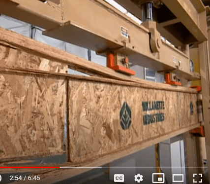

The web splice in the OP photograph looks like a finger joint. The following video shows how I-joists are fabricated in one plant. Webs are made of OSB board. The web splice appears to be a glued butt joint. It passes the strength test(minute 2:45 of the video), but failure occurs at the splice location.

The guy call it finger joint, but looks like just straight pieces glued together. Somewhat differ from the OP's photo.
Indeed, r13, which is why I described it as a "glued butt joint". I believe the "finger joint" or "stitch joint" is probably much better. Failure should not be at the splice.

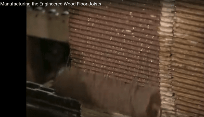

I took another look at the video. Apparently, all four sides of each web panel are run through a profiler, giving them a saw-tooth appearance (see minute 1:20 in the video). So, the ends are not butt joints as I stated above. Perhaps it is too much to expect that failure will not occur at the splice.

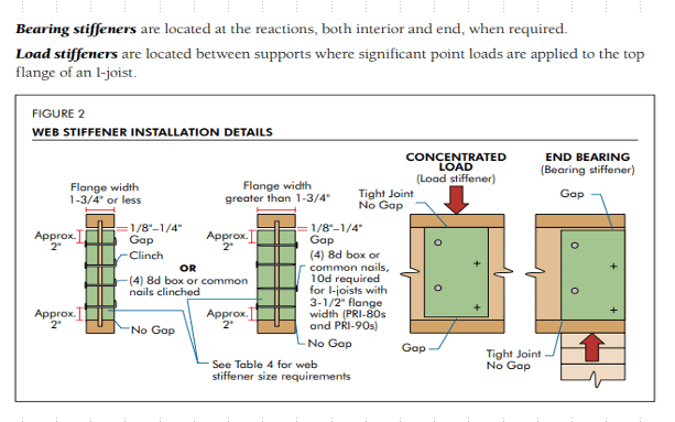

The teeth is too fine to remain contact while the beam deflected, but an improvement from butt joint. I am surprised that there is a lack of literature on the OSB web joint, but I do find details for web strengthening at concentrate load, and the fact that shear deflection is need to be considered in the deflection calculation.
