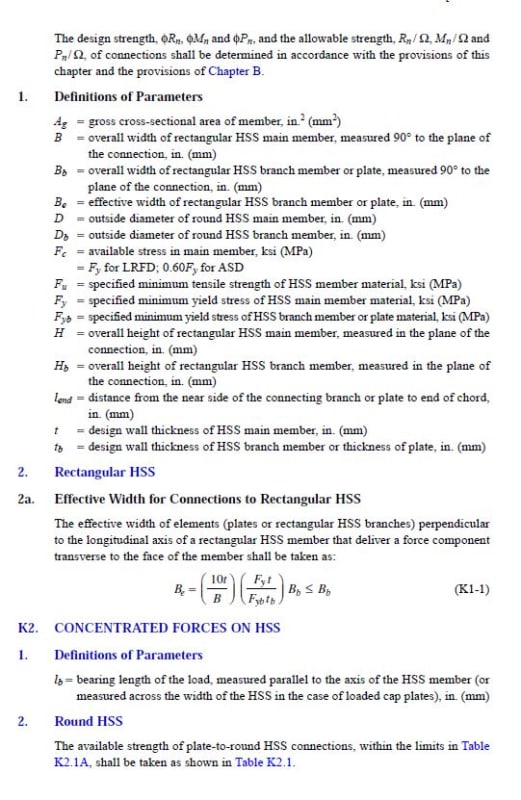

Does anyone have a paper reference or calculation for the yield line solution to a tab welded to an HSS. I have one somewhere, but cannot locate it.
Thanks... but, what issue? 15?... I have the above already in an SMath program, but am looking at how to accommodate the yield line pattern. Most patterns are for straight axial load and not moment. I can develop the yield line pattern for a moment, but was hoping that some publication already had.
the above post is from AISC 15
if you look on the table evo10 posted the table for moment
i believe is from table K3.2 AISC 14th
dauwerda posts the pages for aisc 15th which is 9-16
yield line solution for inplane flexural strength (plastification)

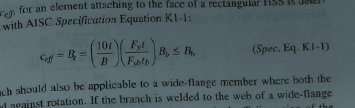

The 15th edition of the steel manual has what you are looking for on pages 9-14 through 9-17. It provides yield line equations for both in-plane moments and out-of-plane moments for both HSS (where the edges of the HSS wall are assumed to be clamped) and for wide flange (where the edges of the web are assumed to be pinned). This was not in earlier editions of the manual.

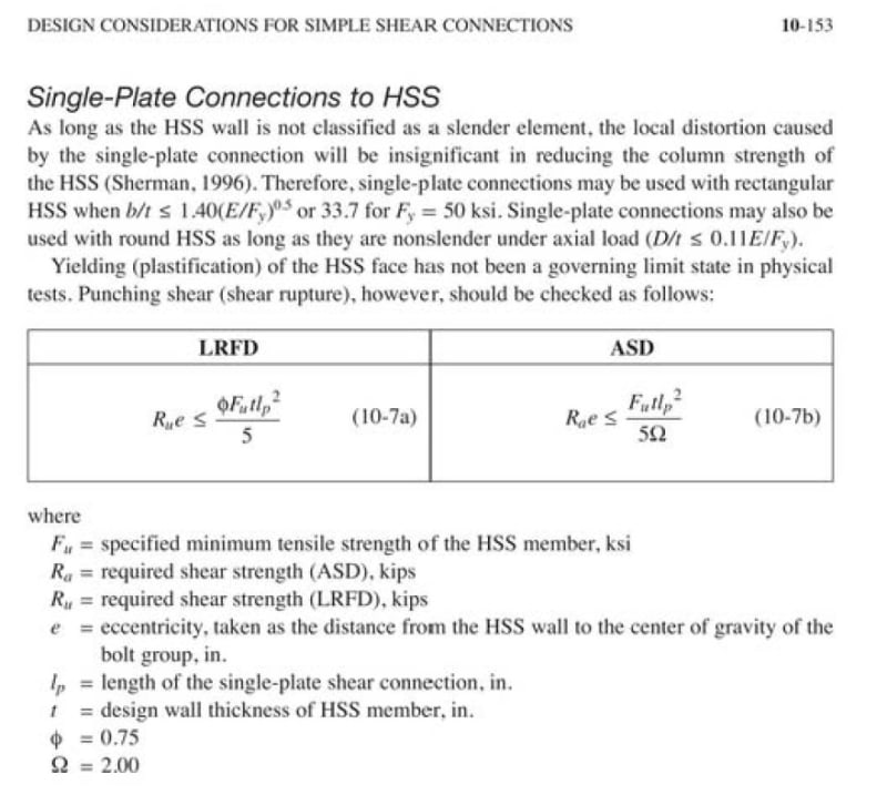

For in-plane moments it does state: "Plastification need not be checked when the rotation is self-limiting, such as at framed, simple beam end connections."
so even though you check it and you're getting it as ' limiting state ' versus shear rupture
ignore it?
I would say engineering judgement would need to be used - I haven't gone through your example, but the stance that AISC is taking is that in the situation where the rotation is self limiting, it is ok if plastification of the HSS happens because it is not detrimental to the system. So, even though it happens, the self limiting part prevents it from continuing and testing has shown that this local yielding does not significantly impact the strength of the main HSS member.
yea, that's ultimately the stance i was taking ... just wanted someone's opinion XD
thanks dauwerda
the strength was just extremely low which was alerting, in comparison with shear rupture

Fyb, tb, and Bb are the yield strength, plate thickness and the width of the shear tab? and plate thickness and the width are the same for a plate and not another HSS? Or do they represent some other value? Also assume Fy, t and B are the yield, wall thickness and width of the HSS?

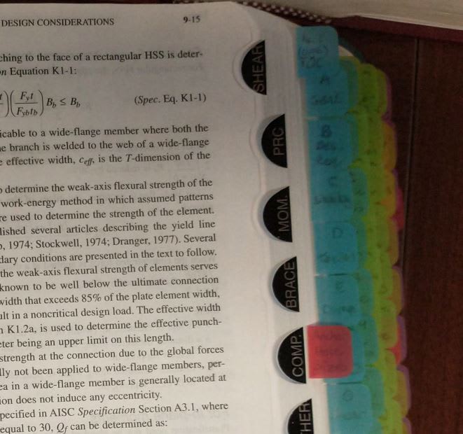

@dauwerda: that looks like some serious, SE exam tabbing to me.... Marie Kondo would be proud.
dik, as that is a reference to the AISC 360-16, I believe you should have access to it, but here it is for your convenience.
@KootK, yes and no - I did tabbing just like that in the 14th edition for the SE exam, I found I liked it so much after the fact, I took the time to do it to the 15th edition as well. The steel manual is one of the few reference I still use the hard copy of - searchable pdf's for most other codes and standards.
