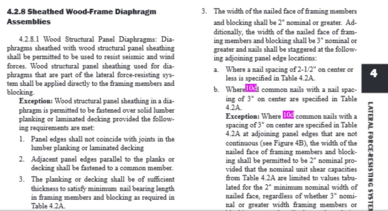

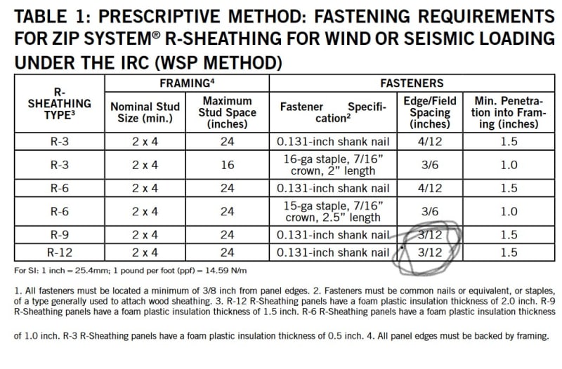

I have a customer wanting to use R12 Zip-R sheathing. (2" foam/1/2" OSB). I hate this crap. Anyhow, the specs require 0.131"Ø nails to penetrate 1 1/2" into the framing. That means they need a 4" long, 10d nail. Does that even exist and for a gun?
So.... 0.131" diameter is a 10d common, right? 1 1/2" penetration into the framing require per their Table 1 (non-engineered) but let's just keep following that. The 2 7/16" thick section and the 1.5" minimum penetration is roughly a 4" long nail. Note that a 4" nail is 1/16" "too long" to go 1 1/2" into the framing, so 1 9/16" penetration, PROVIDED the nail gun doesn't overdrive the fastener.

bookowski - my issue is the structural usefulness of the product. They have 3rd party testing reports for use in both prescriptive braced wall lateral systems and engineered shear wall lateral systems. If you look at the engineered tables, you'll see that you need crazy nailing patterns just to get capacities on par with some of the weakest 'normal' shear wall assemblies in the SDPWS. I'm in the mid-Atlantic near the coast. Most of work is just north of the 'hurricane prone region' line but some of it is inside it. Either way, beachfront homes make up a not inconsiderable portion of my workload. Minimal shear wall capacities won't cut it. I regularly have to specify 3" on center for 15/32" Structural I sheathing, use FTAO analysis, etc. to get these houses to work without introducing steel frames. ZipR makes those steel frames a guarantee on most houses that I work on.
If they didn't replace a critical structural element of the house with Styrofoam, I'd say these things are pretty neat. But they do. So I don't like them.
Yeah, I searched versus looking in the actual NDS, my bad. So it's a 4" long 8d common nail. The comment about the splitting is dealt with in that sense, but the reality of the sheathing (and siding) hanging on the nails remains. They have details to isolate the bottom of the panel from the foundation, but it just makes the hanging even clearer.
I don't much care for the corner detail, either. In a weatherproofing/waterproofing sense.
Oh, and then the fastening guide wants a "shank" nail. I'm not sure that bright nail somebody found up there qualifies, let alone using a "bright" nail (no galvanizing) on the exterior, sure, on paper these nails are supposed to be dry. But reality? Even if we don't have direct water exposure, what about potential condensation on the nails from water vapor? Do you tape over the nails? Also, does anybody trust the installer to do the roller pressure on the tape for the joints?
