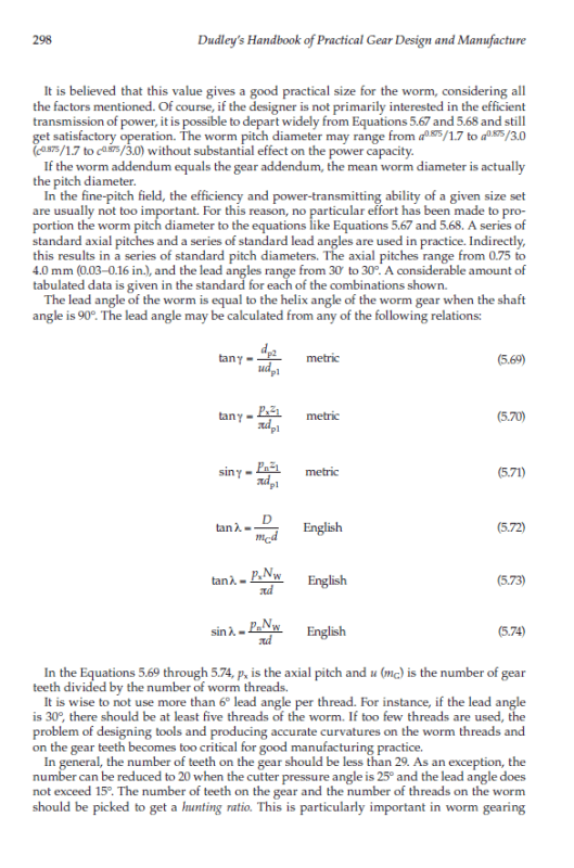

mfgenggear,
I had no mentors, only books, but they are not in English. But look at the formula 5.70 or 5.73 below. The helix angle on the reference diameter is called the lead angle. If the reference diameter is used, you calculate the lead angle, but you can use any other diameter on the worm to find what the helix angle on that diameter is:
mfgenggear said:
...we would swivel to the lead or helix angle. and the helical gears lead would be correct. now I trying wrap my head why on worms. why it would be different.
Here the grinding wheel is also swiveled to the lead angle, so it's not different.
