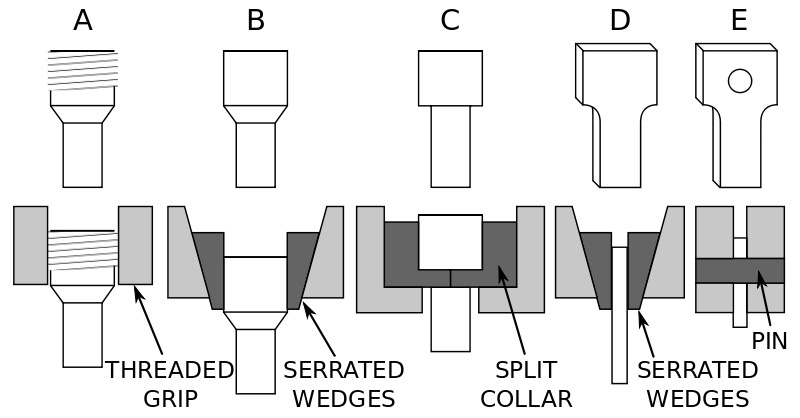

I hope the image from WIKIPEDIA tensile testing is uploaded. If not one can go to this reference and look at Various shoulder styles for tensile specimens. Keys A through C are for round specimens, whereas keys D and E are for flat specimens. Key:
I am referring to the B and D which show A round shoulder for use with serrated grips and A flat shoulder for use with serrated grips.
One can see the wedge like components which are serrated. These serrated surfaces are in contact with the specimens used in steel and superalloys testing laboratories and hold the specimen TIGHTLY. They are not lubricated. In my younger days when I did some South Asian style wresting, we would put oil on our bodies to prevent the opponent from "GRIPPING" us. It is also a common experience that it is difficult to grip with a greasy hands. So why would a serrated surface for gripping specimens be greased?
I do agree that if these wedges have to move horizontally (in the figure) then the "sliding" surfaces of the wedges can be greased for smooth sliding and proper grip.
