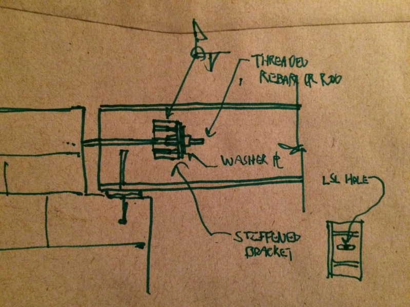

Ok, so I'm looking for some details of how to transfer the forces in a bond beam that is disrupted by a W-shape beam at a reentrant corner. I have attached a crude drawing to show my situation. The bond beam that is parallel to the W-shape I'm going to weld rebar to the beam web and tension splice within the bond beam. I'm not sure how to make the connection with the bond beam perpendicular to the beam web though. Thanks

I remember this from the other thread! Sweet detail. I still have a couple of concerns however.
1) I worry about the constructability of the welded joint between rebar and beam. It looks as though it would require the rebar to be cast into the bond beam such that it would be perfectly centered on the beam web. I'd recommend something that accommodates some misalignment tolerance.
2) Looking at the connection, it appears that it will create an unintended moment connection between your beam and your wall. There could be a few remedies for that:
a) drop the bond beam down a course.
b) don't make the welds until all dead loads are in place.
c) provide a nice stiff beam to limit end rotation.
I think the best idea would be koot's option a. drop the reinforced bond beam 1 course and turn it into a psuedo 2 block beam. Discontinuous horizontal rebar in the top layer (I'd be specifying knock-out blocks), continuous reinforcement in the bottom bond beam, single legged stirrups at some spacing to tie it all together.
I found a detail I may use just have to crunch the numbers. The forces in the bond beam are from metal roof decking acting as the diaphragm from wind/seismic/blast loading. So I need the bond beam to be continuous, or at least transfer the force as though it were continuous. The W16X31 is relatively stiff, only two k-series joists are bearing on it with trib. width of about 15' with 6' spans on the joists.

Yea def. not concrete designers. I do need the connection to the beam web with the bond beam that is parallel to the W-shape to drag the shear into the shear wall. But, I'm going to use the concrete masonry association detail (with some adjustments for splice length and such) to bypass the W shape around the reentrant corner and transition to a bond beam lower in the wall and then transition back up to the normal bond beam elevation
The simplest detail would be to drill a couple of holes through the beam web and thread corner bars to match the bond beam reinforcement through each hole.

Suggest drawing the embed plate and beam to scale (W16x31 has 5 1/2 wide flange, plate looks closer to 4"x6" and only one headed stud is shown).
Suggest adding stiffener plates to the beam at the support.
The sketch below is my attempt to introduce some misalignment tolerance into the connection. Originally, I was thinking that the wall had to be constructed before the beam arrived on site in which case tolerances would be important. Now I'm questioning that assumption. Maybe it is reasonable to assume that the beam will be in place when the bond beam is being constructed. I figured I'd post the detail regardless as I've already drawn it.
