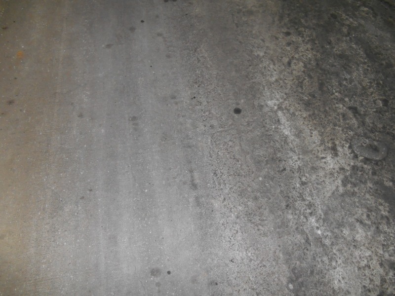

This first picture is some cracking on the left and rough worn areas on the right that are more in the travel path (top surface).

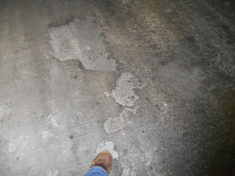

This turns into more rutted areas over time like the picture below.

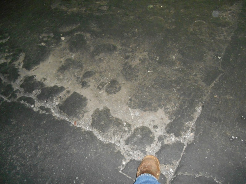

Then this turns into some really cracked and pitted areas.

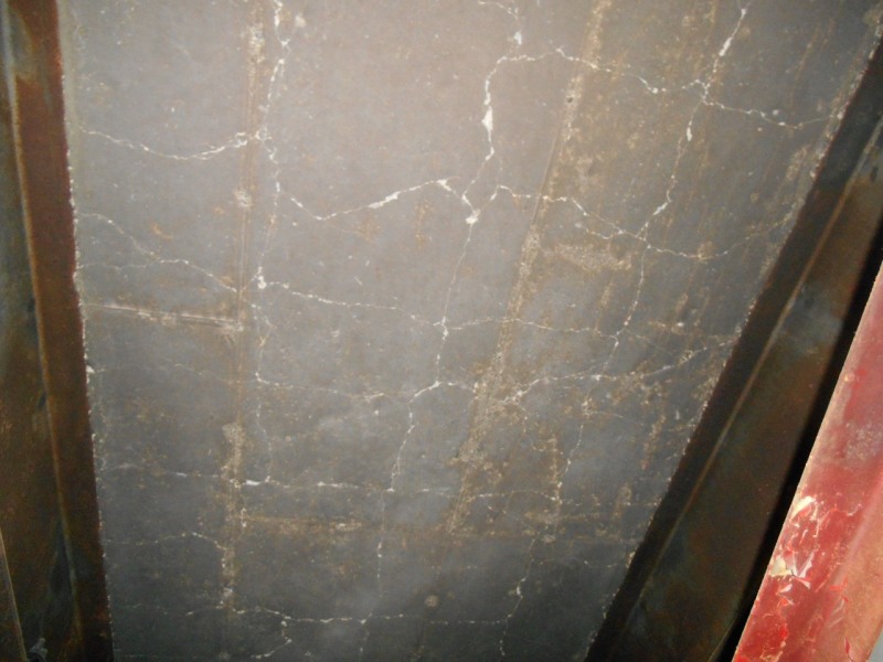

From the underside, there are areas with pan deck and other areas without. Below is a picture in an area without the pan deck showing the cracking that starts to happen before large chunks fall out. The span between the beams in this picture is about 5'-8".

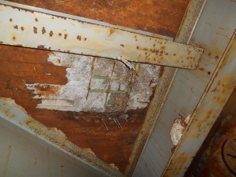

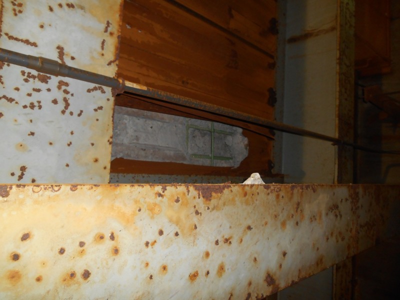

And here are a couple pictures of some areas (with pan deck) where chunks of concrete have fallen.
Must be quite a corrosive environment for the form deck to be completely eaten away. Are there spills on the top or some other reason for the corrosion? Or does the corrosive environment come from below?
The pictures are hard to get an idea of depth, but there was about 2" of cover between the pan and the rebar. The corrosion is from all sides. There are spills of chorides on top and chlorine vapors in the air underneath.
