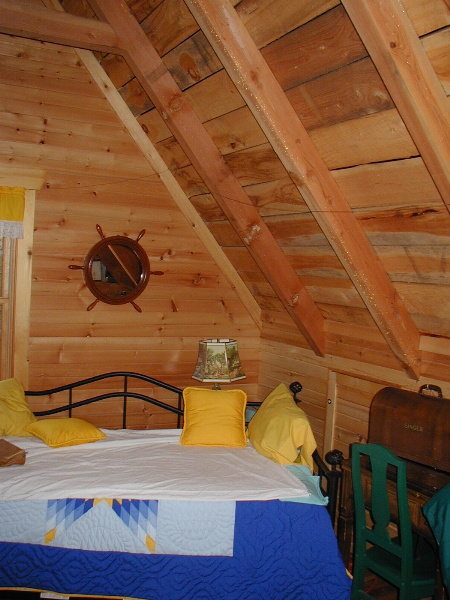

Last year I sold a log house that may have had similar roof, pitch. When building, we lacked sufficient length of ridge "board" (3" x 10") to run the full distances of the ridges. A simple lap joint was made, with no attempt to carry any bending moment. Sorry, but my photos retained now don't have a shot of ridge on inside. But will try to load two photos. The joint of rafter to ridge "board" was simply toe nailing with two 8" timber screws. A few ties at 2/3 height were used with no attempt at a strong joint, but to provide a little benefit for the rafters.
