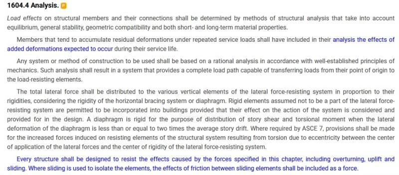

What I keep saying about the unbraced length, is I'm not aware of any testing or research that establishes a wood diaphragm is effective in bracing such a large steel beam for such a large span. The beam, however, is currently deflection controlled so there is some margin to the debate here, as to it being effective or not, if it were designed unbraced full length, that would clearly produce a safe design so long as the end rotation was dealt with appropriately.
I am aware that perhaps 4 out of 5 dentists would consider the beam braced by the wood structure, perhaps even continuously braced, I'm saying there isn't much basis for that, beyond "convention", I haven't seen any research published to substantiate the practice. This is where I keep landing. There isn't a "well-established principle of mechanics" that substantiates the bracing effect. We are in the same territory, fundamentally, as the "inflection point is a brace" which was eventually disproven.
