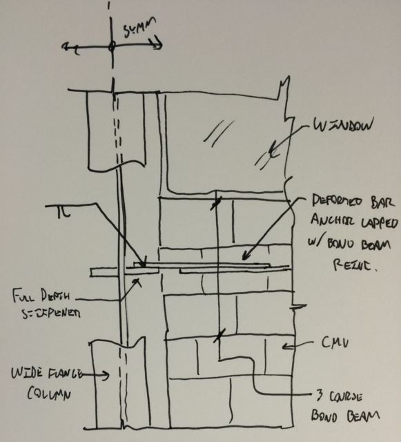

The bond beam at the top of the wall could also be the drag strut member if you can find a way to tie it robustly to the columns at the ends. I've suggested a detail below. This obviously would go part and parcel with your plans for tying the wall into the columns in general.

Thanks for that. Would the following detail work or is a channel normally used due to the compression force. I calculate the force in the girt to be 4.6kN.
If the wall is built tight to the column web does the girt become redundant or am I totally missing the point?
I also have ties shot fixed at 450mm centres on both sides of the column web to tie the masonry to the steel column.
John.
Should be fine so long as all of your connections are designed properly.
Some of each. You're correct in thinking that, with no girt, there's still a load path there (columns lean on block). The trouble, in my mind, is a) assessing that path and b) constructability issues surrounding the mason's ability to build it snug up to the column web. In my opinion, a drag strut / girt member of some sort is required.
