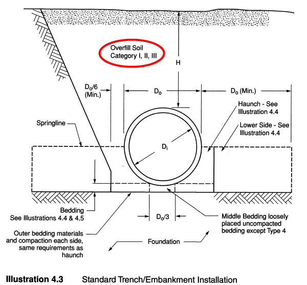

Typically, I use 2 feet of soil cover minimum on top of a reinforced concrete pipe. Do you guys know of some code/reference that prohibits placing rock or grouted stone directly on top of an RCP? To me placing rocks or grouted stone directly on top of a pipe does not make sense, but it would nice to have a reference to back this approach.

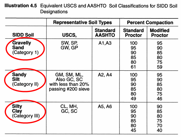

The American Concrete Pipe Association's Concrete Pipe Design Manual specifies soil that is recommended for pipe overfill, rocks are not included:

type 1 "gravelly sand" will have a significant number of rocks and per UCS, "gravel" can be up to 3 inch. are your rocks this big? encasement fill with concrete is done all the time. depending on your specs, "grouted rock" could be classified as "concrete". for culvert outfalls, embedment in rock (gravel or cobbles) is not that uncommon. I would not recommend trying to compact it.
