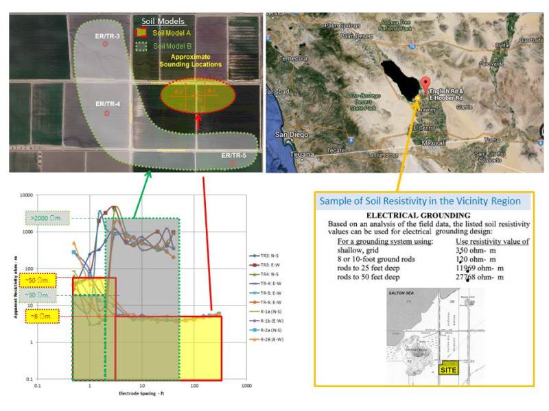

I don't know what you mean by the measurements not being good but if you are trying to create a two or three layer model for the whole thing or something for each section I would just pick the layers to be something conservative and move on.
The measured apparent resistance should decrease with increasing the electrode spacing, we do not see this trend up to almost 7 feet.
Sometimes the soil at deeper levels is higher resistivity than at shallow levels. You could have an upper layer of moist soil and high resistivity bedrock at a lower level. It depends on the nature of the soil. Resistivity measurements can also be influenced by metallic objects in the soil near the measurements, such as fences, distribution line grounds, water pipes, etc.
That is correct for this reason we are interested in soil resistivity of the entire site without impact of any metallic objects as you named during the measurements. The given measurements data are not a good representation for coming up with a soil model.

Also, you may want to probe deeper using even wider electrode spacing, it appears that resistivity may be trending lower at deeper levels.

For what it's worth, your apparent resistivity vs probe spacing measurements for most of your traverses are pretty consistent in terms of the curve shape. Your measurements look to me like there may be a very high resistivity layer pretty close to the surface.
Also keep in mind for shorter probe spacing on your Wenner measurements, you will likely have to correct the measured results based on the probe depth as the spheres of influence of your electrodes will overlap. Depth of your probes should be less than 0.05-0.10 x your probe spacing, which can be difficult to achieve in practice on short spacing measurements. This may not be the cause of your perceived issue, however is easy to overlook.

Soil Test comparison: The tests 3, 4 & 5 are consistently shown low resistivity on the top layer and very high resistance in the lower layer. Tests 1 & 2 are also consistent however, in conflict with the other tests performed in the vicinity.
Are the tests wrong? Not necessarily. In rocky or large layers of sandy soil structure, the lower layer could be of high resistance as shown in the data. It is not unusual in valleys of the West coast with dry desert region near rocky mountain to have such as high diversity of soil in small area.
Suggestions: follow some of the recommendation above with the support of a geotech engineer and verify with additional test to confirm the result of the first test. If this is confirmed, the grounding design and calculation could be still performed using the appropriate information even if there is a high soil resistivity.
For illustration, see the picture below. Good luck.

Consider the following data ranges:
1) Upper layer (above 3 ft) ................100 > ρ > 1.0 Ω.m ([sub]all measurements are consistent)[/sub]
2) Mid layer between 3 to 6 ft ...........1000 > ρ > 100 Ω.m [sub](large diversity measurement)[/sub]
3) Lower layer between 6 ft to infinite.... 100 > ρ > 5 Ω.m for TR cases and
.................................................................. 1 > ρ > 0.01 Ω.m for the R and S cases
Suggested practical though:
The ground grids could be located 24 in below grade in the upper layer 100 and 1.0 Ω.m and ground rods could be used to bypass the mid layer and reach the lower layer at 10 ft. below grade (100 & 5 Ω.m or less). Therefore, the uncertainties on the mid layer measurement could have minimum impact in the overall ground grid design.
[sub]Noted that the low resistivity is associated with aggressive soil corrosivity that need to be considered in the size of the grid conductor and foundations rebar[/sub]
