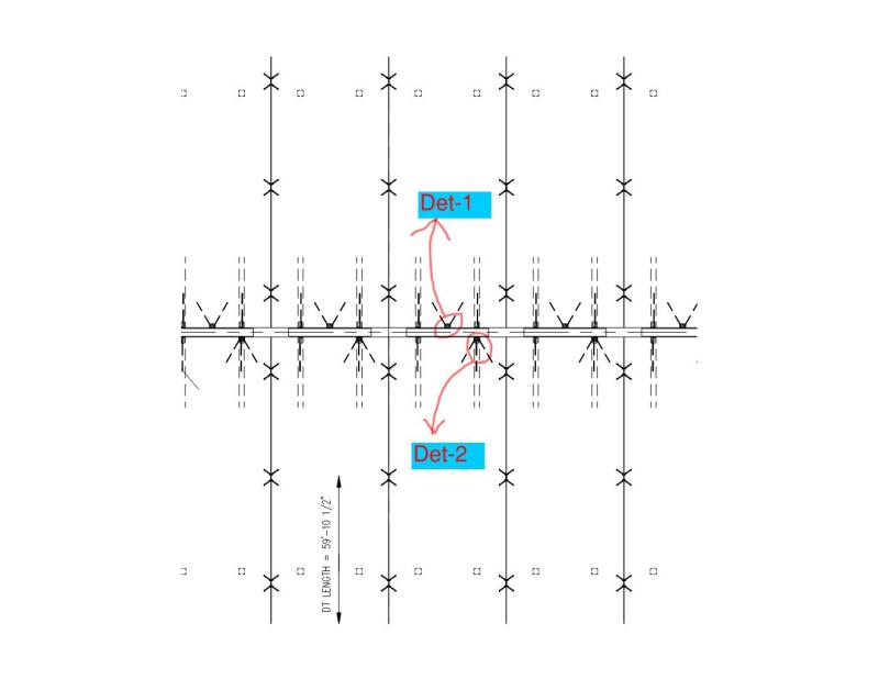

Hi!
Some engineers want to put double tee to litewall connections at DT stems (Det-2)
while others put them in the middle between two stems (Det-1).
What effects do they expect from different locations?
Why don't they place embed plates at the stem like Det-2 where more concrete mass can be used?
Thanks for your comment in advance!
These are lateral/diaphragm connections rather than the connections that support the vertical TT reactions, right? If so, they can be placed most anywhere without seriously affecting performance. And the location between stems would give you great edge distances and minimal congestion.

I wonder horizontal edge distances of 5ft vs 2.5ft make a big difference.
Are they considered as a field?
I think a local failure around embed plate may be more critical.
Isn't there any other reason?

Surely not if they are lateral connections.

Not sure what you mean by this. They may well be considered as in the field for lateral connection purposes.

You're probably right.

You mean besides:
1) If they are lateral only connections then there's really no reason for them to be at the stems and;
2) Congestion is probably reduced if the connections are not at the stems?

It's a minor issue, but when the DTs are loaded the bearing ends will rotate and compress the plastic bearing shims (korolath). I'd think what little additional flexibility there is at the centerline between stems (as opposed to directly over the stems) would add to the lifetime of the connection. Of course this is even more of a problem at the Inverted Tee to column connections where a more compressible bearing pad is used and the welded plate connection must be directly over the beam (countered by the IT beam being more rigid over a shorter span).
