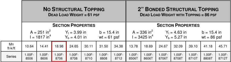

Here is a load table for a 48" plank width, with 1" strand cover, 250 k strand, for both topped and untopped panels:
Full 8" load tables available here for varying bottom strand covers: Link
I am not completely certain what the "8xxxT" designation means, except the "8" is the plank depth, and the "T" is for topped. The other three numerals probably refer to strand # and dia, for example: "8608T" - would be 8" deep Topped plank, with 6 each x 08/16" (i.e 1/2") dia strand.
If structurally warranted, you may have to do some field verification: subsurface radar, probing, visual, dimensional etc.
To check/verify what the designation refers, you could back calc the nominal flexural capacity, Mn, based upon say (randomly selected) "8706" plank (8" deep, 7 each strands of 3/8" dia @ 250 ksi) and see if it gives you 18.98 ft-k/ft, as per attached:

Spancrete and Flexicore are quite a bit different, so you need to be careful using Flexicore tables.
Spancrete series are named as follows: First digit is plank thickness, second is strand diameter (in 16ths of an inch), third and fourth are number of strand, T indicates structural topping. So 8504T would be 8" thick plank with (4) 5/16" strand, and 8510T would have (10) 5/16" strand
The number and letter before the series indicate strand height and core shape. 1.0F indicates 1" clearance with the "F" core series.
Good to know. Thanks for that. I figured I had it backwards when my way would have had a "8712T" designation using 12/16" dia strand - 0.75" - which is not available, as far as I have experienced.
