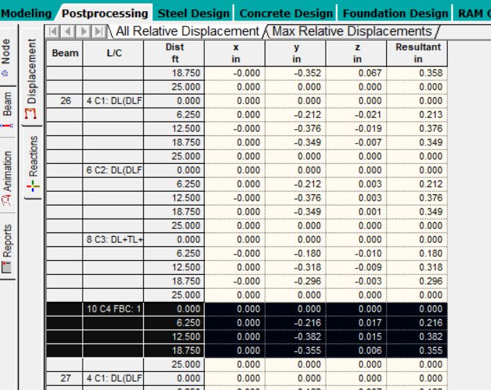

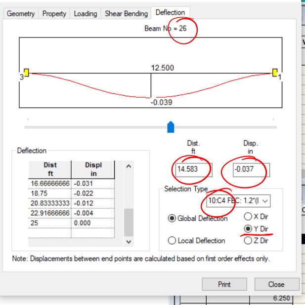

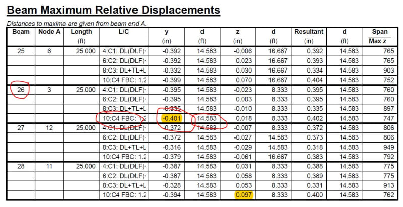

Now I have another question, I printed out the report of the "Max Relative Displacement" for a particular beam. I also did a beam analysis, but the numbers do not match. Does anyone know why? On the report it gives me a max displacement of 0.401" but on the beam analysis screen it only gives me 0.037" which is a factor of 10 difference. I also tried changing the setting from Global to Local deflection and it did make a difference but not by much.
Can anyone give me insight as to why they are different and the difference between global and local deflections?

I think the 0.037" is the beam's deflection based on the load on it (by itself). The max. relative displacements is the displacement at the node(s) + the beam's deflection (for the total).
I checked both nodes on this beam and they only displace by 0.001", practically nothing. [ponder]

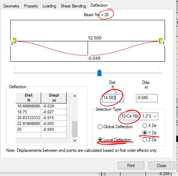

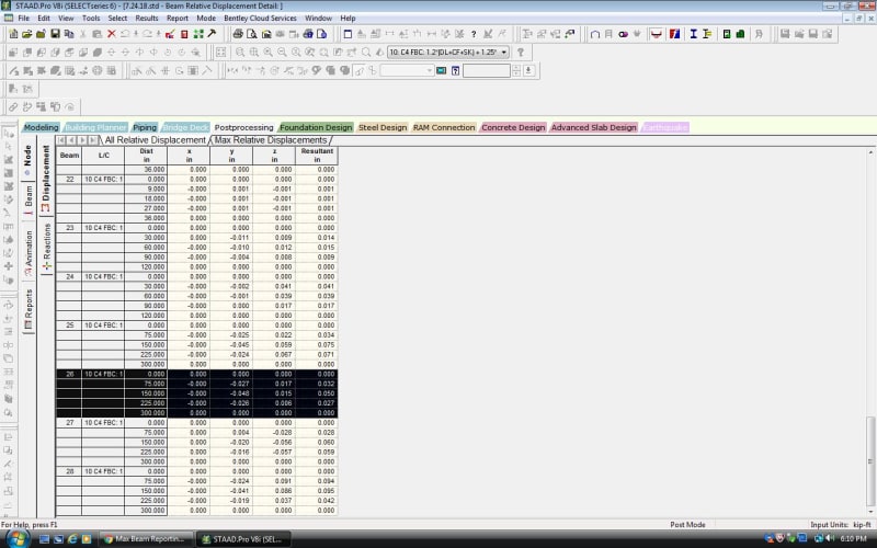

I'm not getting that displacement on my end. So I'm not sure what the deal is. (See pic below. In case you can't read it, the biggest displacement in the "y" direction is 0.048".) The brace runs between a node that is fixed and one that is pinned.....and it is not loaded in between in any load case (except for self-weight).

That is weird. I just pulled the same screen up and I have -0.355" as the max in the y. I do notice that your distance is in ft while mine is in inches. But we both have inches for the y column but yet we get different results?
