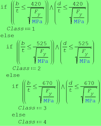

An SMath construct that works... this if for HSS so no w value.
It's an easy construct and can be modified for other b/t or h/w values.
Dik
