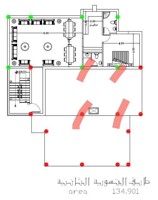

BA I can see that have put bearing walls on the perimeter of the floors, but in the ground floor to roof slab I cant find the optimal interior column placement.
Hoshang I think that the green columns are sufficient for the b2 floor, but the red columns are far from each other and will not make an economical beam sections.
 https://files.engineering.com/getfile.aspx?folder=5085441b-6e62-4de6-97ea-faea7d167db5&file=39.jpg
Please find the attached link.
The green color is for columns continuing only one floor.
The red color is for columns continuing three floors.
There will be main beams between the columns and secondary beams (supported by main beams) for bearing walls lying above open rooms

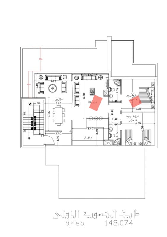

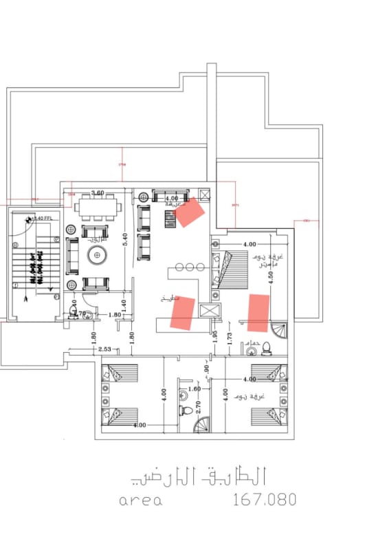

Thank you hoshang, but the 4 columns annotated in the attachment are showing up in the middle of rooms in upper floors.
Sorry TarikHKJ
The red color is for columns continuing two floors.
The uppermost floor will be supported by load bearing walls.
I have added a couple of beams (wiggly blue lines) and four columns (red squares) on the Roof Framing Plan.
Unless you can convince the architect to modify his Ground Floor Plan, I think you will have to support some of the bearing walls on Ground Floor framing. There seems to be no other solution.
