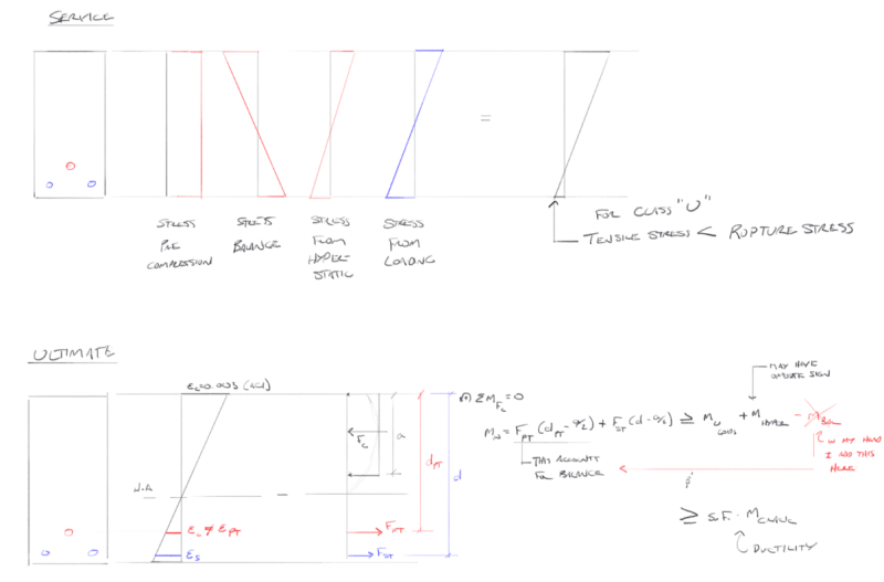

think I'm starting to get it...my edit 3 I believe has whats been giving me struggle when I only try to mentally think of the moment capcity vs actually write it out.
Reality is phi*Mn >= Mu,factored applied loads + M,hyperstatic but in my head I want to do phi*Mn >= Mu,factored applied loads + M,hyperstatic - M,balance. If I did what's in my head vs what I write then my check on the moment would be double dipping on the balance force.
Edit: In the ultimate force diagram there is no F,pt compressive force at the cross section centroid because the P/A compressive stress is already accounted for in the parabolic stress distribution since we've essentially continued along the load history from the service stress-diagram and pumped the strain up to the ultimate strain.
The F,pt tensile force can be directly used even though its in a greased duck for the same reason you can use both chord forces in a truss section cut between panel points, in other words simple statics.

Firstly, You are getting mixed up with your Balanced Moment and Msec. Balanced includes Msec (P.e + Msec).
The other problem you are having is thinking of the service case in its simplified working stress methodology while you are looking at ultimate as strain compatibility.
In the simplified service case, if you do as you do at ultimate and include Msec in the applied stress and treat the PT effect as P at an eccentricity of e, then you will get exactly the same result but the logic is the same as for ultimate.
If you look at service as strain compatibility assuming concrete has tensile strength and a linear stress/strain for concrete (triangular diagram) then the methodology is the same as for ultimate.
The difference for the PT at ultimate is that e increases as the neutral axis rises and P increases as the tendon extends due to flexure. So you have (P + DeltaP) . (e + deltae) as the effect of the prestress.
It is even easier if you think of the concrete as a parabolic stress/strain curve as it is then an easy progression from service to ultimate. The rectangular stress block complicates it by making ultimate look different to service.

Think we are on the same page now with exception that I am/was using the wrong terminology.
What you suggest in your last paragraph made things much more clear I essentially just kept stepping thru the load history and drawing new strain and stress diagrams considering a parabolic stress profile for the concrete.

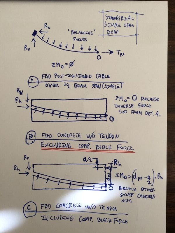

OLD KOOTK QUESTION:
In the ultimate flexure calculations, you always see the PT force placed at the level of the PT. How did it get there given that it started off at the end anchorage elevation and, in unbonded PT, there is no mechanism for the transfer of "bond stress" between the tendons and the surrounding concrete? No bond equals no strain compatibility, right?
NEW KOOTK UNDERSTANDING:

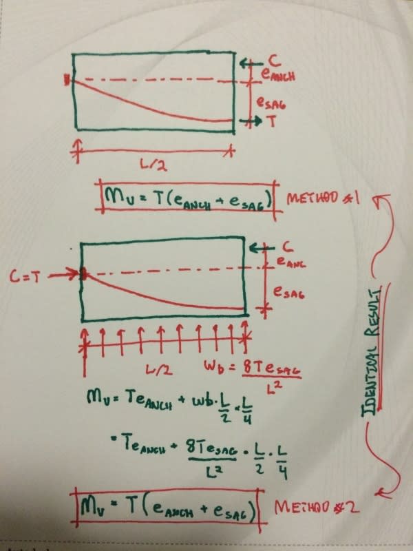

In draped PT beams, flexural resistance can/must be considered to be coming from two, independent but related sources:
1) The effect of the axial pre-stress acting alone and reducing cross section demand for tensile reinforcing.
2) The balancing load effect from tendon curvature effectively acting as a transverse loading on the concrete member to counteract external loads.
It is true that the balancing load can only be counted once, and I've stumbled on that myself in the past. However, it is also true that the balancing load effect is an integral part of the flexural resistance in a post-tensioned beam with drape.
The big takeaway for me considering the original question (read it again now for good measure please):
The applied PT force really has not moved from the elevation at which it originated at the anchorages. For flexural analysis, the unbonded PT force can be placed at the level of the tendons at any cross section because what is actually being represented is the summation of effects #1 & #2, described above. The balancing force stresses are essentially replaced by an equivalent, faux eccentricity to the original anchorage forces. And the net effect is just as rapt has described: P x e.
The first sketch below is my examination of the situation considering the tendons and the concrete as separate members, each acting upon the other appropriately. For some reason, I find that presentation a great help to my understanding.
The second sketch is me using two different methods to determine flexural capacity, proving that both are valid and just different sides of the same coin:
A) Conventional P x e where the balancing load effect is buried in the "e" value.
B) An alternate formulation where the balancing load effect is considered explicitly.
I've got my fingers crossed hoping that I've added something meaningful to the conversation here for you. Otherwise, I'll have wasted a good chunk of football Sunday for nothing! Ah well, all investments are risks.
Note that most of what I've described and sketched is for simple span beams. Things get a bit more complex when secondary effects associated with continuity etc are considered. I've done things as I have not because I don't recognize that complexity but, rather, because the added complexity tends to obfuscate the truth of the points that I've tried to make.
