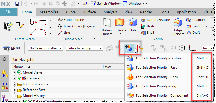

Why NX doesn't select the parts which is right in front on the screen but instead select the promote/linked bodies buried deep inside an assembly? Is there any way around so that cursor select the part which is shown on the screen not the hidden behind other parts?
its so frustrating. sometimes I yell why NX is so stupid. I understand there is a quick pick option to find part from a list to select. Also I couldnt find any option in "selection preferences" to change it.
Perhaps your selection priority needs to be set differently. This can be found as a dropdown list of options on the selection bar (or use command finder and search for "selection priority" to find it quickly).

Three things:
[ol 1]
[li]When it comes to selection, NX is typically only as smart as the person using it (or setting it up) in many cases.[/li]
[li]Learn how to properly use Selection Filters.[/li]
[li]Learn how to properly use Selection Priority.[/li]
[/ol]
You probably have your Selection Priority set for Features to be the top priority. If that's the case, then in the context of an assembly what you're observing is expected behavior (since there won't be many features in an assembly). Type in Selection Priority in the Command Finder to see all of the options - that will help somewhat but using the Selection Filters before you try to select specific objects will probably help the most.

These are "a type of preference" similar to a selection filter, and placed where such should be placed,
But , by default, not displayed. Note the hotkeys in the image, these are still active despite the pulldown invisible. Maybe you press one of these un-intentional and by that set the priority wrong ?
