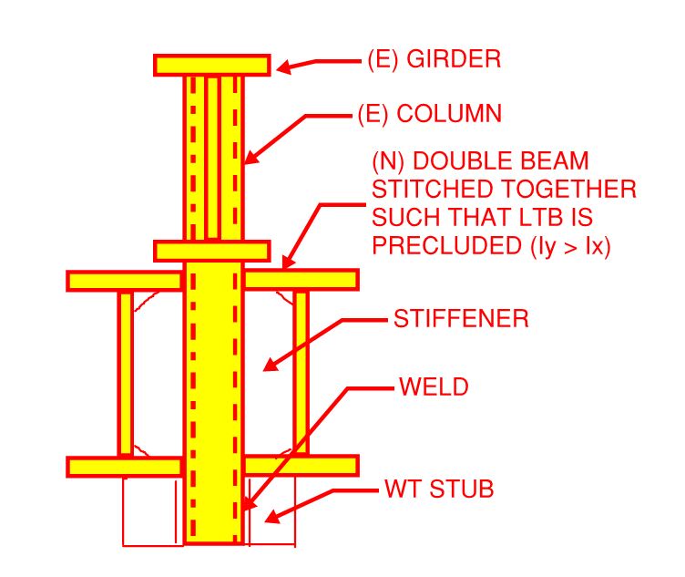

Instead, I would use a (likely heavier) W27, or what ever size is necessary, to support a point load at it's center with an an acceptable unbraced length of 24'.
This also avoids possible complications of how W18s share load with a W27. Keep things simple.

I have had a similar situation recently and did similar to what SlideRuleEra is suggesting:
We specified some angle kickers to help brace the new beam top flange.
This is an amalgamation of some of the fine ideas suggested above with one nifty feature: LTB is precluded.
