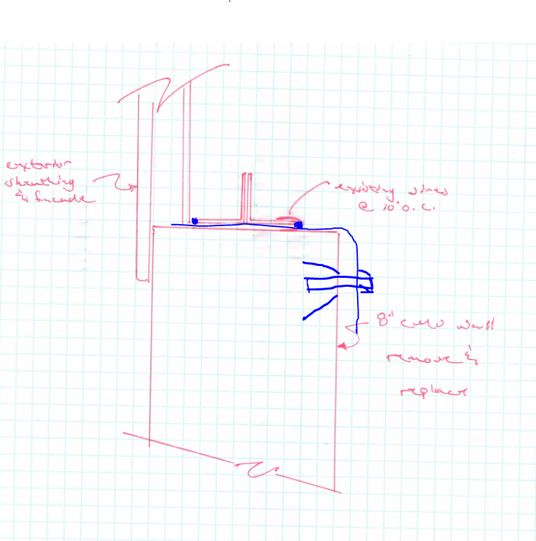

I have an existing building where the owner would like to install some new openings in the perimeter of the building. Code is IBC2015/ASCE7-10.
The existing building is 50’s to 60’s with riveted clear span gable roof trusses supported by perimeter columns and infill 8” CMU. The existing trusses/column connection contains a knee brace from the column to the roof truss (I’m thinking/assuming these knee braces resist lateral loads).
The owner would like to install 2 new overhead doors in the gable end of the building. Due to existing window locations, we think it’s better to remove the existing wall in its entirety and reinstall a new 8” CMU.
The issue I have in regards to attaching the new wall to the existing truss (see attached sketch). I have two options I usually default to in similar situations
1) Come up with an angle/expansion bolt detail to attach the truss to the new CMU wall
2) Install nelson studs along the bottom chord of the truss and grout the nelson studs into a bond beam.
Both options are not great. Does anyone have a better detail for this situation?
The existing wall has wire ties at 10" o.c. +/- attaching the masonry to the existing truss (shown in the sketch).
At this point, CMU is the direction we have not plans to get away from the CMU so please do not offer a solution that uses other building materials.

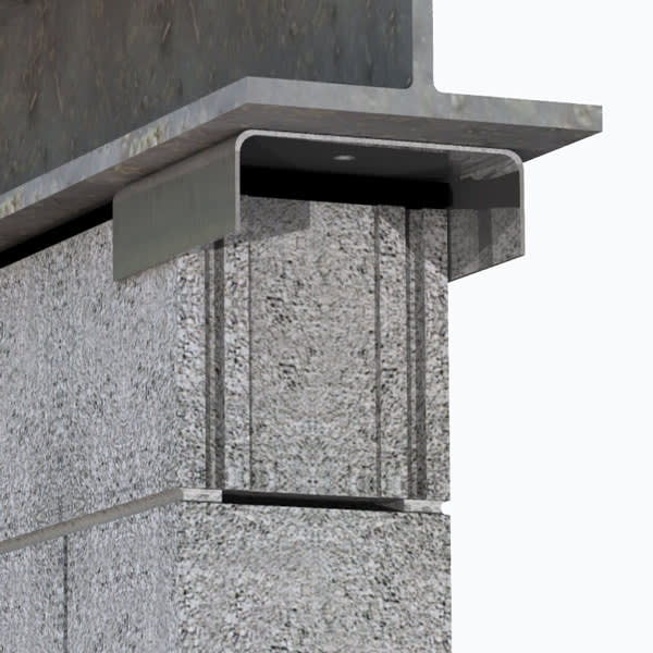

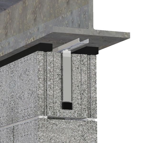

The proprietary partition top anchors designed for out-of-plane-only have a slotted track for in-plane freedom and a compressible gap at the bottom to allow vertical deflection. I suppose you could use that if you find a simple way to attach the track to the truss. But I’ve never trusted those dovetail track things to not bind up, same way I don’t trust that slotted hole connections will allow movement the way we hope.
The bent plate type does the same thing and may be simpler and easier to fix if it does bind up.

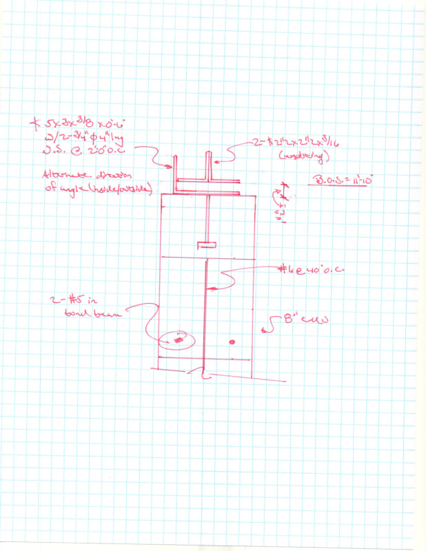

bones, I was considering using a modified phamENG detail to reflect your second detail. I was thinking about installing two angles (maybe 4" long L6x4x1/4 LLH or a bent plate 7x3x1/4) at 2'-0" o.c. staggered. One angle would be toed down inside face, the other would be toed down outside face. I might try to get them to buy that detail. I can see them balking at it a bit as you might see the angle on the outside of the building.

If you look on the detail I provided, they currently have wire ties at 10" o.c. attaching the existing masonry to the BC of the truss...... these angle should do the same

The nice thing about the bent plate is it’s like 12 gauge thickness, so you could attach each one to the truss with a few PAF’s. Quick and easy, and they don’t get in the mason’s way. Also thinner and easier to hide with siding.
So after some thought, this is what I came up with (I hope the image works):
I think this solves almost all of the issues.
Alternate direction on angle (toe inside toe outside)
Seems like a decent detail. Might be a little challenging to build, having to keep the angles in just the right place while grouting.
I would extend the verts into the top course to provide a positive mechanism for shear transfer.
Oh yea...I guess that's what "alternate direction of angle" means....[banghead]
@SteelPE: What is the nature of the system that laterally braces the bottom chord of the truss? Horizontal trussing at the ceiling level? I wonder if that might be used to advantage. Also, in your latest detail, I'm concerned about the ability of the masons to wet set those clip angle + stud assemblies. You'd almost have to slide them in from the side as you go as you constructed that last course of block.

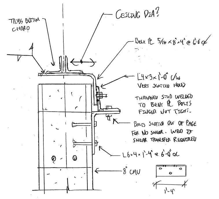

Couldn't resist taking a swing at this.
- Lots of parts and pieces but easy to build on site. Everything could be done post-wall if desired.
- Sketchy reliance on slotted connections. For low stakes and an indoor exposure, I'm willing to bend on this.
- Easy potential to make an out of page shear transfer connection if desired.
