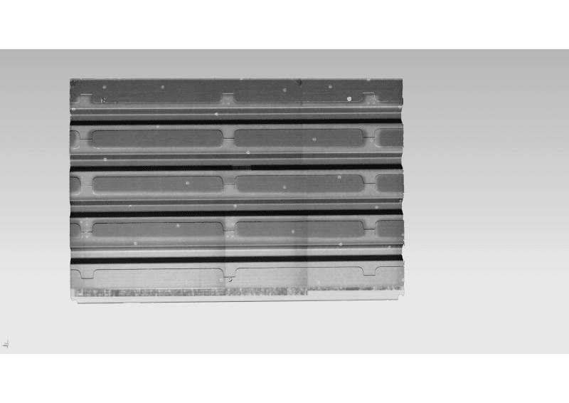

Attaching images to 3D model in NX
Nani-789
Jan 8, 2020
DE
I wanted to know if there is a possibility to attach different images to 3D models in NX. If it is possible, is there a way to map the normal flat images to curved models. I tried using raster images but i couldnt exactly attach them to 3d model.
Thank you guys for your responses. But the point is, i have already used the 2 methods i.e raster images and decal stickers. In raster images , the images can be placed and adjusted but it can be fixed or projected on CAD model and in decal sticker, the image attcaches as a sticker to the CAD model. So i am searching for some other better way to process it. I have attached pictures so you can have a look.[URL unfurl="true"]https://res.cloudinary.com/engineering-com/image/upload/v1578579278/tips/raster_image_d9vudq.tiff[/url]
