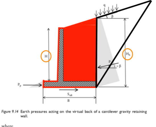

I will make you a tricky question now then....
Please have a look at the two pictures below, its the same wall however in the second one, i highlighted the retained soil above the heel just to show what would happen if the highlighted section was also concrete? (it is said that the retained soil above the heel inside the virtual plane is assumed to be part of the wall)
According to everyones comments above, in the 1st case (picture below) everyone would use the height of the wall H to calculate the total active earth pressure Pa
However in the 2nd picture everyone would use the height of the sloped soil Hh
Therefore the result is that you will have the same Coulombs Active Earth Pressure Coefficients but use a different height
therefore you will get higher Total active earth pressure Pa for the 2nd case?

I agree with his point. For structural design of the wall use the height to the top of the wall, but for global stability and sliding the height should be to the fill level above the back of the heel.

For stability, I consider height H1 for active pressure calculation. Because the largest wedge of soil which is trying to slide or overturn the wall away is applying pressure at face bc. All smaller wedges are supported by retaining wall.
For design of wall, height of soil at wall face is used to calculate the pressure on wall.

The failure block shown is from Rankine theory, which valid only on a smooth vertical surface without friction. Coulomb's theory considers all, thus is preferred.
Both are Rankine, evident by angle of the resultant force and the vertical plane.
Shazbot. My original response edited. I can only say that it's been awhile since I considered stability of a semigravity wall... MSE wall is similar...
Agree with using the h1 height for the concrete wall design, and h2 for global stability/overturning effects.
Look up the concept/term called 'virtual back of the wall', basically this states for stability you imagine the forces acting on a virtual plane at the back of the soil that's over the footing (basically identical to your "2nd picture" above).

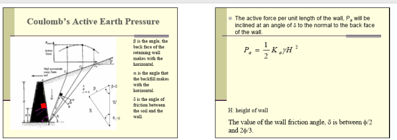

The graph below may help you to compare these two theories/methods. You need to estimate the friction angle of the soil and wall friction in order to calculate Ka using Coulomb theory though. (I suggest to try ∅ = 25°, and δ = 0.5*∅ - 0.75*∅)
