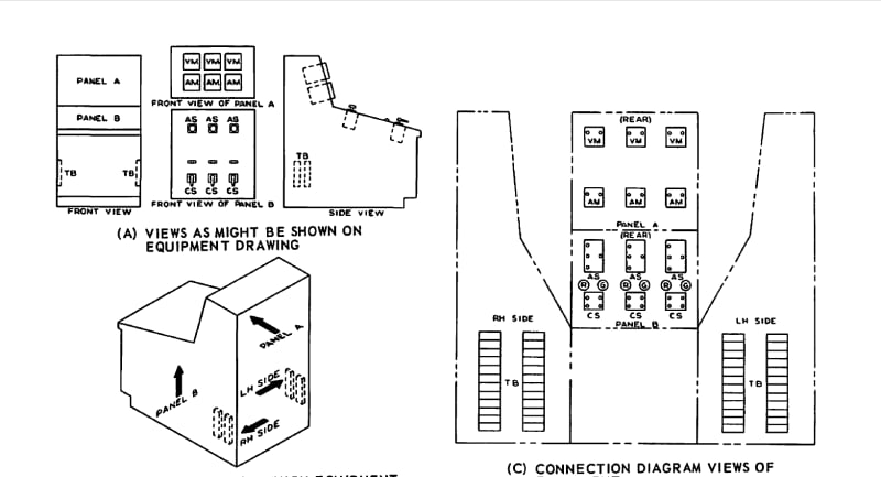

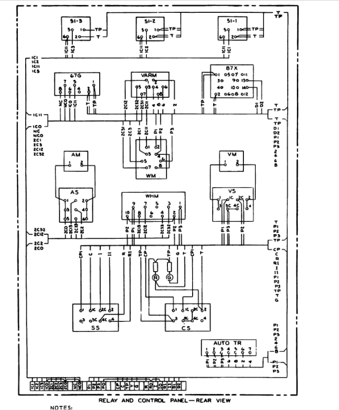

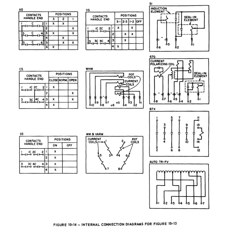

Anyway, reason I ask is I found some 60's drawing showing a power plant where the 115kv feeders are only protected via 51 & 67G relays- amp, volt selector switches/gauges and watt hour meter on each feeder. Everything screams islanded radial operation. I have to admit, it looks really elegant.
The control panel:
