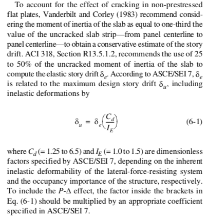

Next question for anyone familiar with ACI421.2, when doing the lateral analysis to determine the out of balance moment, just wanted to confirm whether the bit of slab modeled inside the column also has the 0.25-0.5 stiffness reduction applied as per the slab span outside of the column? EDIT the reason I ask this is initially I applied the reduction tot his region also, but the only way I can get the same moment as the ACI example is to only apply the 0.5 reduction beyond the column area and use full I_s in the column region

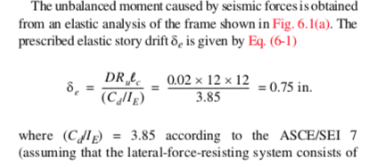

Thirdly, in the example attached, one thing that makes no sense to me given I don't practice in the states and are not really familiar with the inner workings of US loadings codes, is that they are checking this column/slab connection for 2% drift but then they come up with 0.75" drift when the elastic drift or compatibility drift this connection will see will be 2% x storey height of 12' = 2.88" drift (i.e. same as shear walls in building). Why is the drift being reduced, seems illogical to me if the floor system is going along for the ride to 2% total drift as stated? For example they are stating at 0.75" drift these upper limits are not applying, but they sure as eggs will if you push it to 2.88" drift...

After a bit more reading I've noted one error I made, I also think I have the wrong equation for η for this situation. This screenshot from a Canadian paper suggests a different equation for η applies when looking at the equivalent frame for lateral loads and taking column heights at half the storey height.
Correcting the l_c/2 error (see updated attachment) gets closer but suspect I still have the η equation wrong and thats my issue. I understand what it generally represents as an effective stiffness factor but cannot find anything on how its calculated exactly? Can anyone lead me in the right direction here?

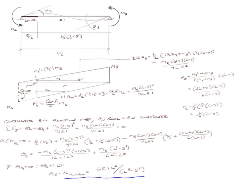

You could do slope-deflection for a fixed-pin beam loaded with a unit rotation at each end independently then solve for the Ma/Mb ratio, same process as getting K for a prismatic beam.
Celt83, as you suggested if you take the rotational stiffness of a fixed/fixed member under a unit end rotation the stiffness is 4EI/L, for a pinned/fixed member its 3EI/L. Therefore 0.75 times the column stiffness going to one end pinned from fixed/fixed condition.

Here is what I get for K:
For the carry over factor set theta,b to 0 and solve the Mb/Ma ratio.
ah shoot my K is wrong that would be if the Column-Slab joint was pinned going from the roller to the joint. You'll need to work out theta,a and then solve for Ma assuming Mb=0 and theta,a = 1 that will give you K for proper direction.
Cheers, yeah you're right, but that example should be enough to work through it with the one end fixed. I'll post back the solution after working through it.

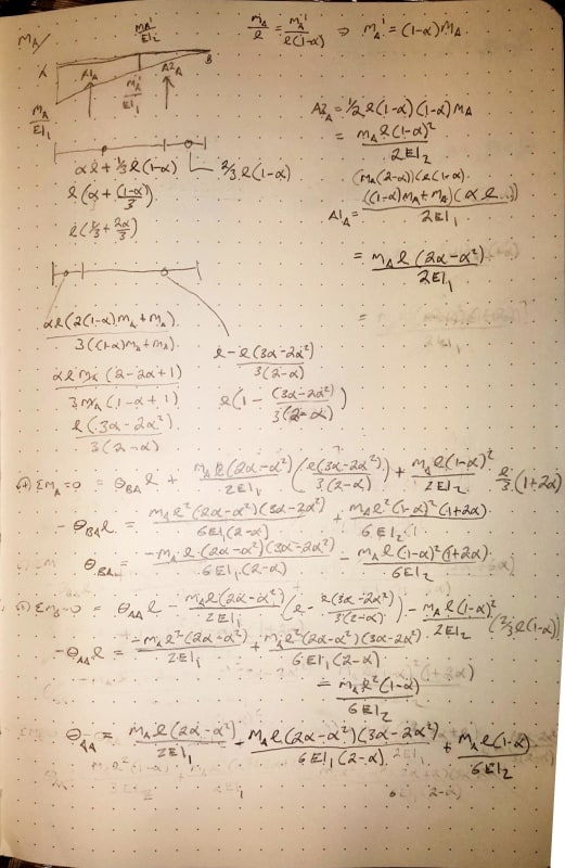

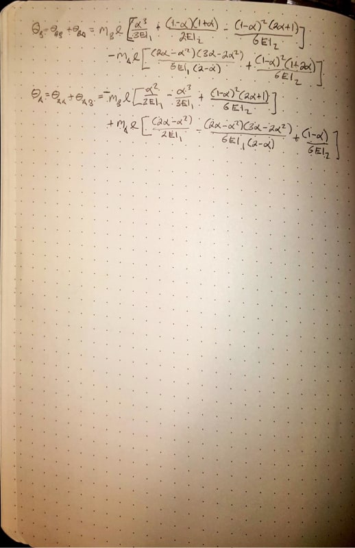

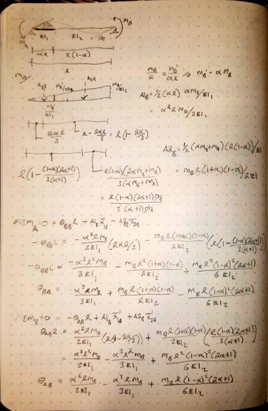

Ok kept getting tripped up trying to solve it specifically for L/2 and S/2 so did it more generally for a beam with 2 sections separated by alpha*L, checked this one with alpha=0 and 1 and get the normal formulas for prismatic beams as expected.
So I spent a bit of time re-looking at this yesterday. I simply could not seem to get the ACI equivalent column stiffness answer with the use of your spreadsheet Celt83.
But I did manage to determine the relationship they were using to get the 1320in^4 effective column stiffness for anyone that follows in the future.

Anyone got any comments on the 2nd and 3rd questions from the original post?

I recently joined the ACI 421 committee and there is an ACI conference at the end of March I'll ask some of the other committee members your remaining two questions then if they don't get answered prior. For question 2 I'd say as it is defined in the document should be 0.5*Is but I've seen several examples that also use 1.0*Is within the slab column joint.
