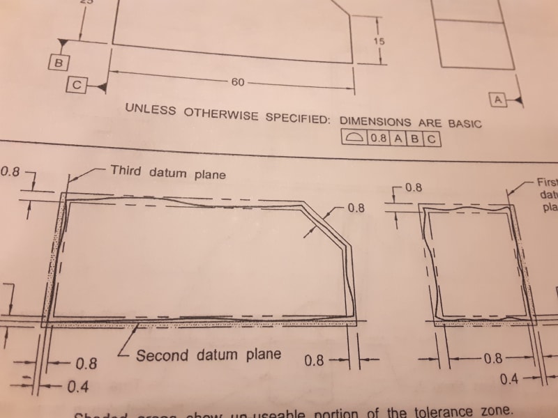

Another thing I noticed in the 2018 standard is the graphic on page 264. On this forum we've discussed how having a profile tolerance reference a datum derived from the same surface might make some of the tolerance zone unusable (because the datum plane is created from high-point contact).
But I'm pretty sure they goofed on that picture: It says "Shaded areas show unusable portion of the tolerance zone" -- yet the entire zone is shaded.

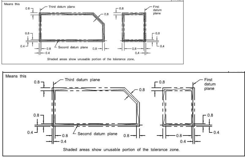

I guess if you look on the released for public draft(11/24/2015), figure 11-21 (Rev C, 2015-07-19) the shaded areas show un-usable portions of the tolerance zones correctly.
Just some area (on the front view and on the side view) are shaded and not the entire zone.

Would you please post the correct figure of fig. 11-21, I can't see the half shaded tolerance zoom no matter how I zoom it. Thanks
Season
SeasonLee,
Here you are.
Shaded areas show un-useable portion of the tolerance zone.
Thanks greenimi, My pdf version is fully shaded on all tolerance zone.

And my print version (received two months ago) also has a fully shaded tolerance zone. There must be different printings out there.

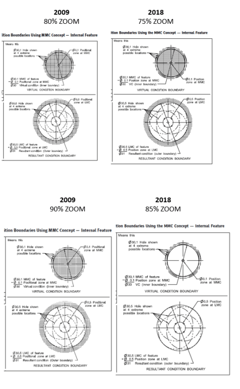

Take a look at my (17 Feb 20 13:28) post. Unless your pdf version is radically different than mine the shading actually goes from fully shaded to empty/unshaded depending on your level of zoom. Ie: zoom in real close and the shading disappears entirely. Looks like there was a formatting error during the final release and it never got caught.
Actually now that I've dived deeper into it, looks like this issue is prevalent throughout the 2018 standard. The formatting is messed up at close zoom and the shading disappears entirely on many of the figures. This was not present on the 2009 standard as far as I can tell. I'm actually very surprised that nobody on the committee caught this. See attached for a full comparison of different zoom levels, and below for a quick snapshot of the level at which the shading disappears in 2018. Note I tried to quickly scale the two so they started at approximately the same size at the lowest level of zoom (why theres a 5% discrepancy) but I was too lazy to continue this through the different levels, I just went by 10% increments. I did though on the final level of zoom.
Take a look at the last slide too - notice also the loss of detail on high levels of zoom, the 2018 has much bolder lines which tend to muddy exactly what is being shown or indicated by leader lines. The figures have much finer detail in 2009. Disappointing.

I messed around with the page display settings, including "Enhance thin lines" which was already checked when I made those snapshots and none seemed to make an appreciable improvement in the issues that 2018 shows. Some did reduce the quality of the image though like the smoothing options.

The committee likely didn't see the effect because the committee doesn't do the final compositing and layout. OTOH the publishing group doesn't generate the artwork so it's not clear who would be responsible for this. You can look at the properties to see what application generated the PDF, but that won't tell what generated the source artwork.
chez311
I can see all figures' shaded area on my 2009 version no matter the percentage of zooming, so I don't have your problem as shown on the attached. But on my 2018 version, I can see all shaded area except only at 125%, 150% zooming. As for the fig.11-21, even I can see the shaded area but it fill on all tolerance zone.
So can I - the issue isn't with the 2009 version. Those shaded regions display fine for me as you can see. The issue is with 2018, I just provided 2009 for comparison.
Strange, I checked it on Adobe Reader XI (11) and DC, same issue at the same level of zoom. What version of Adobe are you using?
