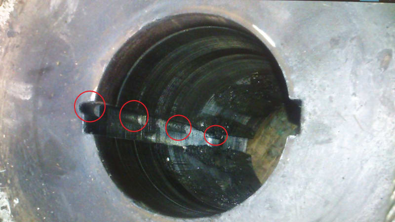

what is a cause of small notch in rotor laminations keyway?
and why it does rotate and move along the rotor stack length?
Does it mean that laminations must be rotated and turnover along with the rotor stack?
It's difficult to understand/comprehend mechanical arrangements without visual representation.

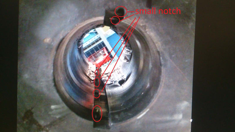

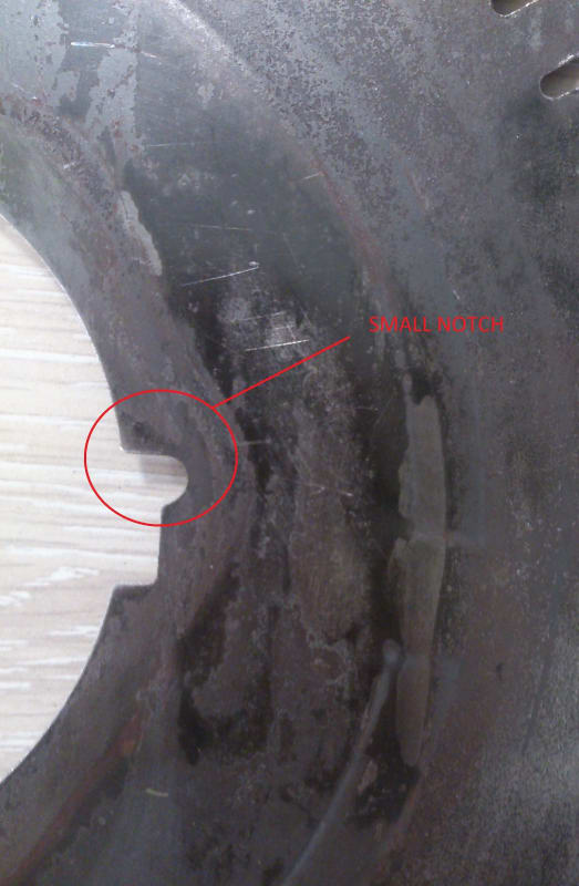

Please consider the attached photos, I hope the enclosed picture help to clarification about the notch in the rotor laminations.in addition, this notch moves and changes position along the stack in key ways.

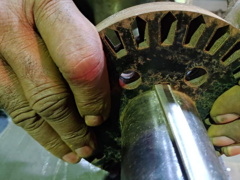

That is the assembling notch which shows the punching direction. When the core punched out, there will be burrs at the edges. When you stack the core, you align the core for the semi circular notch so that all the burrs are in the same direction. If you do not align the notch, like flip the plates, then the burrs will bite into each other creating stacking issues and possible core shorts. Sometimes, there is also a guide pin in the notch used to assemble the core and it is pulled out once the assembly is done.

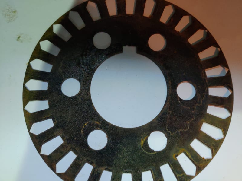

Could that also be a flow channel to help varnish impregnate the laminations? The round notch widens one of the square notches.I see tolerance match-up problems to get laminations to fit tightly to the shaft and two keys. Are the round notches all one side or alternating sides for balance when stacked?

CP - The plates are usually pre-varnished during manufacture as sheets before punching. If the laminations are laser cut (which is fashionable now), then they are post varnished after cutting since the edges get burned during laser cutting. No varnishing is done after stacking. The notch is one side only so that you can't flip the plates horizontally or vertically during stacking. I agree that two key ways do not make sense and will create match up issues. Probably, they use only one key way in this case. OP can clarify.

in this type of motor, there is a skewed angle during stack and small notch move irregular in the corner of keyways, Could this be due to the rotation of the sheets or turn over the sheets during stack?
and Is it necessary to have a rotating or turn over the plates in the rotor stack?

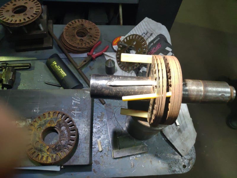

Does the key way in the shaft match the rotor slot skew which is usually one slot pitch? The notch should line up for every plate. Post the rotor shaft pic with the key way.
Muthu
no, it doesn't match the keyway in the stack and skew. actually, there isn't keyway in the shaft.
Good demo! It's obvious from that the stacking skew controls the slot skew.

stator only has some track of cleating machine in outer diameter and there isn't any skewed angle or key, On the other hand, the rotor has two straight keyway and small notch with the skewed angle in slots, but I don't know rotor laminate had rotation or turn over before punching for orientated effect, and it's necessary for rotor or not?
Some motors skew the rotor lams, some skew the stator lams, and some don't skew either. It is a motor design issue.
