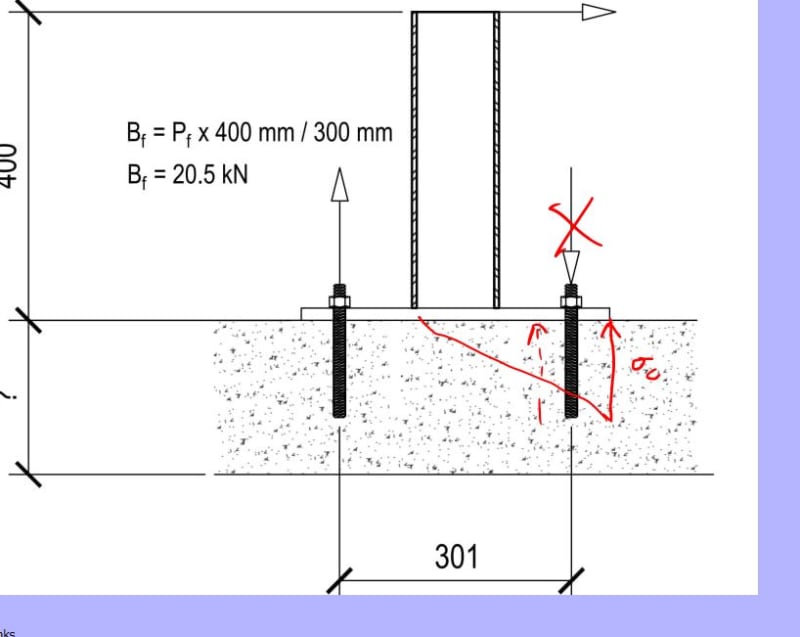

Hi all,
This question is more general than specific.
I have a structural member that has an applied horizontal load. The structural member is welded to a base plate and the base plate is connected to the concrete slab with anchor bolts.
If we assume that all anchor bolt checks are fine (and structural member/base plate checks), what failure modes are required for checking the floor/roof slab?
I have sketched the force couple applied to the slab below:
Thanks,
