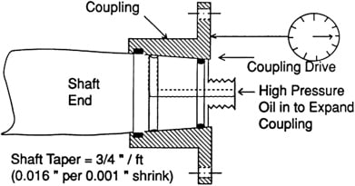

I am looking for some help.
I have a internal tapered sleeve that needs to be pushed up a solid tapered shaft (similar to old propellor methods). I need to push it up by 1mm.
I am presuming that the thickness of the sleeve in the middle is 8mm, and the length is 115mm. The angle is 5.9 degrees inclusive. It will be steel/steel - no lubrication so the friction could be taken as 0.15
The Sleeve is 115mm Long, Taper Small End ID 64.50mm, Taper Large End 79.40mm.
What I am looking for is to calculate the axial force required to move it 1mm into position. Can anyone help?

I take this to be a cone on a cone and the 1 mm travel is from the point the parts solidly mate, is that correct? There are online press fit calculators that I think would get you in the ball park. Just assume the interference that you will get with the 1 mm travel.
You know the geometry of the taper. Therefore, you know the 'stretch', increase in diameter due to pushing the axial displacement 1mm. Maybe equally divide the strain between the sleeve and hub. Calculate the strain, then the stress and interference pressure. Then calculate the force required to cause that stress plus the force to overcome the friction.

Make your life easy and use oil injection.
