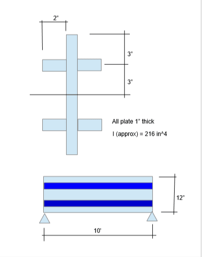

This exactly I intended to do, a new thread for open discussion. Let me throw a hypothetic problem, to get opinions on the method/thinking in design the weld connections as shown on the sketch below.
Assume a simply supported beam with uniform load "w". Design the weld required to hold the stiffeners.

How would you attack the problem posted above, if you are the reviewer, say the designer has specified a weld size deemed inadequate to qualify the build-up as an integral unit in resisting shear and moment?
I respectfully disagree that there is no shear flow, at least for the center plate. Then how the stiffeners feel the shear stress across the connecting planes? Through conformation of displacement, the stiffeners must have stress in them, my question is what is this stress, and how we calculate it by practical, or theoretical method.
I could be wrong, so I would like to see how others think about this to clear my thoughts.

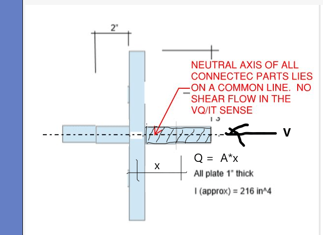

@ret13: I'm fairly certain that I'd design your example exactly as you would: classic VQ/IT. That said, your particular example is not a valid example from the perspective of this discussion because the component parts do not share a common neutral axis. Your example, rearranged to fit this discussion, would be as shown below where there would be no horizontal shear flow in the VQ/It sense.
For retired13's unrelated problem, there is not enough information to solve it, either give us the shear or the beam span so the shear can be calculated? But you solve it using the standard q=VQ/I equation like any other shear flow problem, where the area you use for determining Q is one of the out-stand plates. But this is a little off-topic from OP's question as the components are not aligned with the neutral axis.

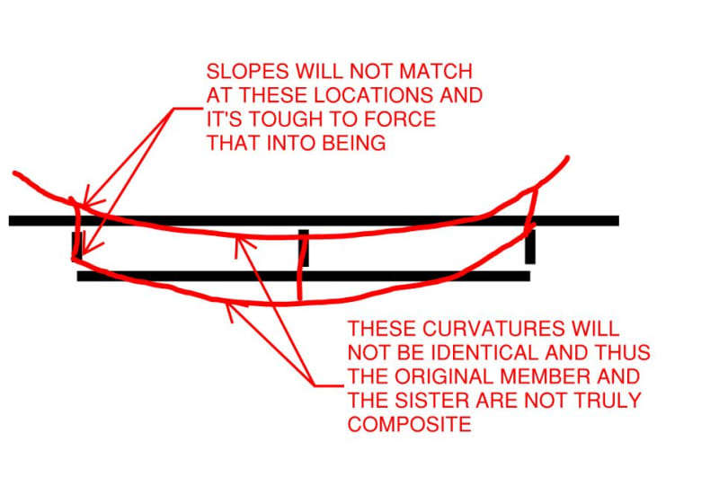

With regard to the partial length sistering, to elaborate on Agent's stuff:
1) Without the ability to impose nearly instantaneous slopes to the ends of the sister, the member curvatures will not match along their overlapping length and, thus, the members are not technically flexurally composite.
2) To keep things simple, I'll often just model this situation as offset members connected by three rigid links and do the fasteners accordingly. Toss in some consideration of locked in stresses and jacking and I see no great benefit in getting any fancier. If it's a very long member, maybe I'll go 1/3 or 1/4 rigid links.
Thanks for pointing out the difference. I've revised the cross section. The span length is 10', with an uniform load "w".

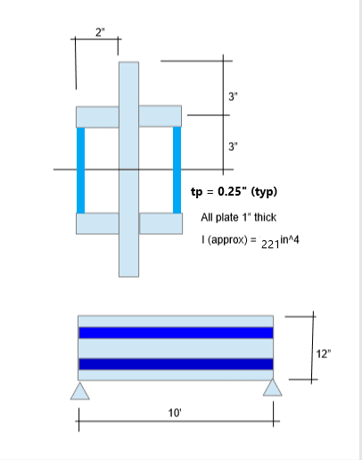

Any comments on this connection?
[Note] On the section above, the shear center coincident with geometry center, thus there is no torsion, but shear flow is non-zero. My understanding is "shear flow of a cross section is equal to zero can only occur in where V = 0".

THE TWO COMPONENTS OF COMPOSITE FLEXURAL FASTENING
3) All components of the cross section must be induced, by the fastening, to assume the same curvature along their independent axes. This is usually the low demand aspect of fastening demand.
4) Where the joining of the components would increase the moment of inertia of the assembly above the sum of the separate components, the fastening must also axially extend and axially compress the component parts uniformly. This is usually the high demand part of the fastening demand as outright elongating or shortening a piece of steel really takes some doing.
THE SPECIAL CASE OF ALL COMPONENT NEUTRAL AXES BEING COINCIDENT
When this is the case, #4 is unnecessary and #3 is all that applies with respect to the fastening. This should make intuitive sense because, really, if your moment of inertia isn't going to get pushed any higher than SUM(Ix_components), why should you have to pump a ton of capacity into making that happen? You shouldn't, of course.
HOW TO FASTEN WHEN THE COMPONENT CENTROIDS ARE COINCIDENT?
It doesn't take much really. And there are two options. In step by step fashion:
1) Based on the ratio Ix_component / Ix_assembly, figure out how much load goes into each competent part. This will create a condition wherein all component parts have the same centroidal curvatures along their lengths and share a common cross section strain profile (this last bit is really what the crux of composite flexural action is).
2) Having determined the load on each component, the shear and moment diagrams for those components become determinate. They are what they are and they need to be internally consistent.
3) The problem now becomes one of imposing the requisite shear and moment diagrams from #2 on the component being fastened given that it may be that no external load is applied to the component. There are two fundamental approaches:
a) Transfer increments of shear from the assembly to the component to replicate the shear diagram that the component should have. This will result in the desired moment diagram falling into place. In this case, the welds would be designed for vertical loads only of a magnitude equal to the distributed load going to the component divided by two, applied top and bottom. This is often how we do it in wood and the fastening demand is very light except, sometimes, at reaction points, cutoffs etc where large amounts of concentrated load must be moved in or out of the component locally.
b) Transfer increments of moment from the assembly to the component to component to replicate the moment diagram that the component should have. This will result in the desired shear diagram falling into place. In this case, the top and bottom weld lines would be designed for horizontal loads only of a magnitude equal to [V/h], varying along the length of the beam [V = shear; h = distance between weld lines]. This is the method that I would favor for this application given that the path for vertical shear transfer is made a bit flexible as a result of it needing to pass through the channel flanges and induce transverse bending there.
One or the other of 3a or 3b will usually make more sense than the other based on the connection style etc. Where it's not obvious, I'll design for the worst of both cases. It's usually a pittance either way.
One could certainly be forgiven for getting the impression that #3a and #3b are both versions of "shear flow" (especially #3b). Both methods do move load around via weld shear after all. For me, the difference is that neither method attempts to impose a uniform axial strain on a component of the section which I take to be the thing that defines a classic "shear flow" problem. I suppose that another way to look at it is to say that the coincident centroids case is really just a special case of the shear flow problem in which it is possible, but not necessary, to transfer load into the component members via horizontal shear.

For the cruciform condition, it becomes yet another special case in which:
1) Load sharing must be via vertical shear transfer transmitted by the welds (my 3a above).
2) Load sharing cannot be via horizontal shear transfer transmitted by the welds (my 3b above). This is because this path requires meaning separation between the weld lines.

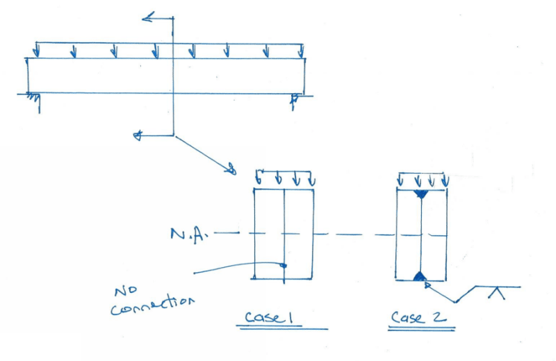

Without regard to the sharing of a neutral axis, if bending occurs, then shear flow is developed when you have two different materials connected together by welding or bolting.
This is incorrect. See sketch below. Case 1 and Case 2 are the same size plates - the combined properties of each case are identical, the bending stress in each case is identical. There is no shear flow in the weld. The weld is not required. There might be some compressive stress in the weld due to the fact that the weld is part of the overall cross section, but the weld is not restraining two components from slipping relative to each other. There is no shear flow.

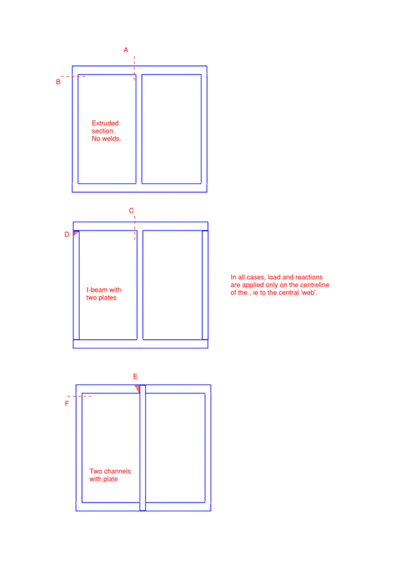

I'd like to hear thoughts (and reasoning for the differences between the three cases, if any) on which of the interfaces and notional cuts (named A-F) in the image below experience shear flow. D & E are welds, otherwise the interfaces are within an extruded/rolled section.
