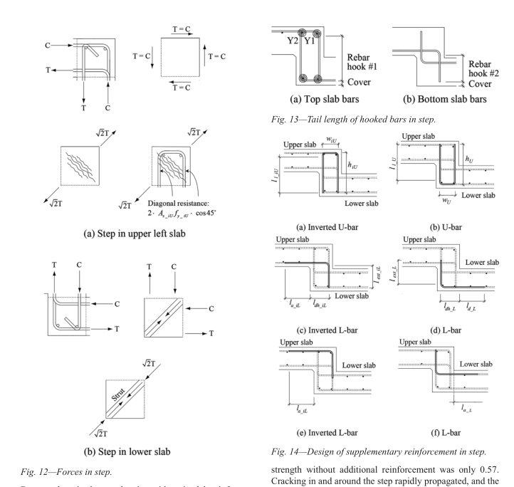

If you have an ACI membership take a peak at this reference:
Title: Reinforced Concrete One-Way Slabs with Large Steps
Author(s): Thomas H.-K. Kang, Sanghee Kim, Seongwon Hong, Geon-Ho Hong, and Hong-Gun Park
snip of general force transfer and recommended supplemental bar layout:
JAE - those were the exact provisions I reviewed before making a comment. Although I looked at them on ACI 318-14 because I need to start getting used to the new layout. That is a story for a different thread...
Celt83 - that is a really good reference. It is going in the database. I don't think it entirely applies here though, as it appears to primarily discuss steps along the span and not at a support.
Yeah I'd agree that it's not applicable in it's entirety here mainly because it's only a soffit step in a region that likely is only ever the compression face, barring any possible force reversals.
Span or support doesn't really matter I think the detailing rules established can be applied to either as long as you are paying attention to where the tension and compression faces are, span likely bottom/top and support likely top/bottom.

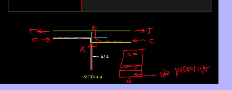

One thing I would watch out for is not designing the moment at the right face of the support using the full depth of the cross section. You will really end up with a lower effective depth of the compression block as it tries to form a strut between the higher and lower slab.
(Pardon the sloppy annotation, trying to use a mouse with the snipping tool is not a great idea)
Celt83 - good point. The normal practice here is to extend the bottom bars (from the left hand side) into the right side some distance and only use the shallower depth "d" for the negative moment.
JAE:
yeah I agree that would be the normal approach, but most of the software people are using isn't built around the normal practices it is just looking at what the cross section geometry is at the design moment point. So end users need to keep stuff like this in mind.

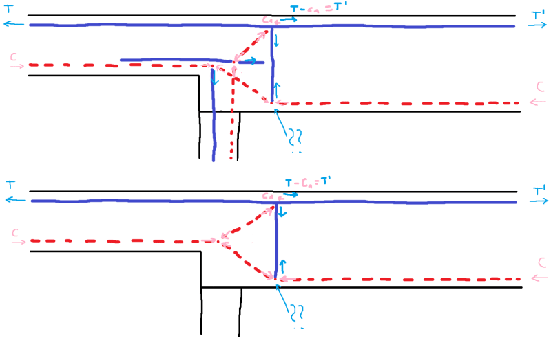

Shouldn't this also have some vertical bars at the strut bend? I drew it, hope it's clear from it (I marked the area in question with ??)
I know that the upper picture is a bit complex and it's not perfect, but I wanted to show that all the reinforcement can be utilized. I think that the lower one is more elegant, as far as the drop part at least. I might be wrong, though.
The top reinforcement would always be controlled by the section on the left side of the wall anyway, with the lower slab depth and this reinforcement would extend to the right of the wall, so to me that is not a problem, unless it is really bad software!
Rapt I think those are compression struts for strut and tie not alternate rebar layouts
