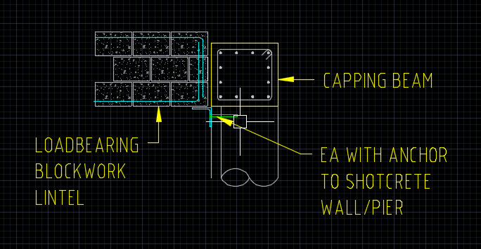

Hi all,
Below is the connection one: RC beam sitting on top of capping beam. Does this connection look ok? If so, can I replace 'Z' bar with 'L' bar lapping in RC beam above only and drill into capping beam? Also, How do I determine the size and spacing of the 'Z' bar? All I can think of the use of 'Z' bars here is to resist the shear from capping beam due to soil being retaining, so I simply check the shear?. Anything else that I missed?
Below is the connection two: Blockwork lintel connecting to capping beam. What will you do? Is hilti rebars or the like an option? If so, can I use one row only considering I want the connection to be pinned as long as the shear passes.
Thank you.
![S1_q8wwou.png](https://res.cloudinary.com/engineering-com/image/upload/v1589367616/tips/S1_q8wwou.png)
![s2_nviov0.png](https://res.cloudinary.com/engineering-com/image/upload/v1589367717/tips/s2_nviov0.png)
