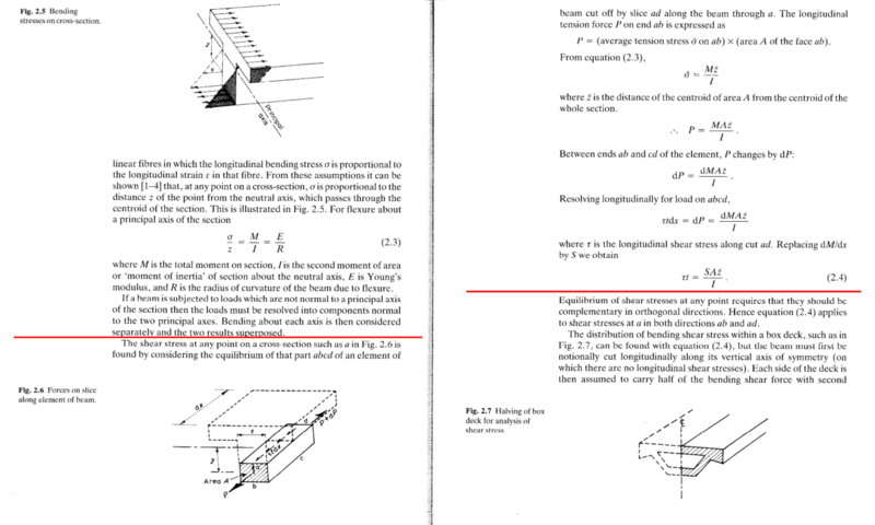

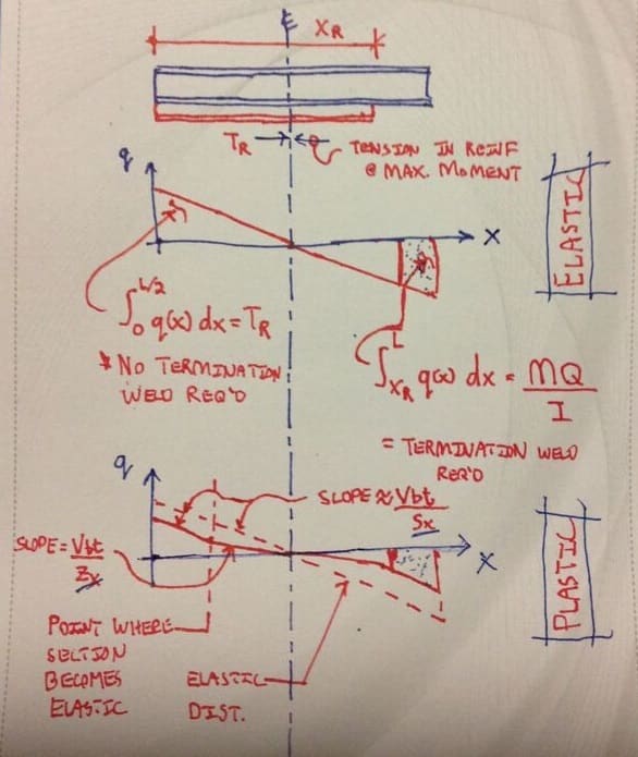

Check out this thread where I dug deep into this and some related issues: Link. It gets rolling near the posting of the sketch below.
Attempted summary: by the time that you get to the section where the reinforcing is needed, coming from the unreinforced side, utilizing the reinforcement requires that you have locally developed a total shear flow equal to the VQ/It shear flow that would have been required between the termination point and the end of the member if the reinforcing had been run out the whole way. Mathematically, that's the MQ/I that you see in the literature: the missing area under the shear flow diagram as shown below. Toss in a little extra for shear/tension lag and you've got your "development length". It's much better explained with pictures so definitely review the other thread and report back here if anything requires further explanation.

I like the method (or way of thinking) in the image below, which fundamentally works for elastic and plastic distributions (you need to use the plastic stress distribution in plastic zones obviously) and which I presume gives the same answer if both methods are correct/equivalent. I believe your M*Q/I (elastic case) could be re-written as (delta_M * z_reinf/I)*(Area of reinforcing element) which would be equivalent to the image below if I understand correctly. BAretired's method from the other thread is a limiting case of this method, where he uses two sections at maximum and minimum bending moment (ie a fairly long distance apart) and averages the weld requirement. I've seen this before but not been convinced it gives a good distribution of welds; my provisional opinion is that it relies on weld ductility and safety margin more than I'm comfortable with, though I acknowledge that it does have a track record.
I believe that's correct so long as your delta_M ceases to represent the traditional, infinitesimal beam length and is instead taken as the moment at the location where the reinforcing is theoretically required less the moment at the end of the beam (zero for simple span). Of course that just reduces to the absolute moment where the reinforcing is theoretically required.
steveh49 said:
..which fundamentally works for elastic and plastic distributions..
Agreed, working with the moment increment rather than the absolute shear for shear flow is advantageous for the plastic situation.

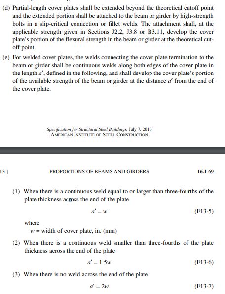

Below is AISC requirement on termination of welded cover plate, the concept is the same for beam reinforcing element.
AISC 13th said:
For welded cover plates, the welds connecting the cover plate termination to the
beam or girder shall have continuous welds along both edges of the cover plate
in the length a', defined below, and shall be adequate to develop the cover plate’s
portion of the strength of the beam or girder at the distance a from the end of
the cover plate.
(a) When there is a continuous weld equal to or larger than three-fourths of the
plate thickness across the end of the plate
a' = w (F13-5)
where
w = width of cover plate, in. (mm)
(b) When there is a continuous weld smaller than three-fourths of the plate thickness across the end of the plate
a' = 1.5w (F13-6)
(c) When there is no weld across the end of the plate
a' = 2w (F13-7)
Nice contribution retired13. Paragraph (e) deals with the minimum length of the development and speaks to the tension/shear lag effect that I mentioned previously. I feel that you could make a pretty good argument that those values ought to be increased for other kinds of reinforcement where the centroid of the reinforcement is further from the connecting welds. Paragraph (d) defines the capacity of the end connection and would be in line with the discussion above.
