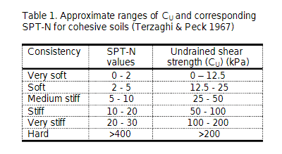

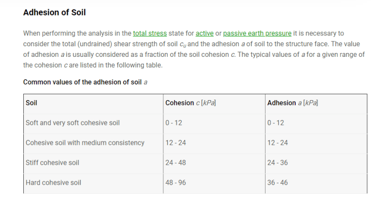

From my limit knowledge and research on this matter, you may follow the steps to find the corresponding adhesion value:
1. Correlate Cu with SPT.
2. Determine cohesion using relationship below.
3. Determine adhesion from chart below.

Note that the data posted by retired13 is only applicable to an undrained analysis.
Actually you shall get the number directly from the lab. Use the suggest method only when there is no option.

The very high Cu number below 6m indicates a very stiff soil. Even it is quite "hard" between 2m and 6m below ground.
The chart below does not agree my interpretation above (stiff vs hard):)

What is the relationship between Su & Cu? I don't think it is one to one though.
