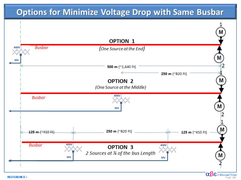

Hi all,
new 2 overhead cranes of 500 meters travel on the same busbar rail needs 900A feeding. the plan is to feed from 3 different points due to voltage drop. Voltage is 400V.
we requested single feeding but they state it's technically impossible.
what do you think on this? it is like that?
Thanks in advance
Martin.

See if the suggested options on the sketch below can help to address the voltage drop issue in a long radial busbar. It is suggested to analyze the optimal solution considering evaluating technical and economical these and any other alternatives.

Hi Che12345,
Thanks for letting us know your opinion regarding the safe operation of the crane bus with multiple sources.
So far I am under the impression that we are in agreement that option 2 with a single source feeding the crane bus in the middle could reduce the voltage drop approximately 50% as option 1. If that meets the voltage drop criteria for this job this will be a promising option to consider. I also like the idea of blocking temporarily the second crane during starting the first one.
Regarding multiple sources, the benefit can reduce the maximum voltage drop even further. For example, the voltage drop of Option 3 could reduce to voltage drop in 25% of the option 1.
To address the potential safety concern there are alternatives to consider. Perhaps the simplest one as proposed by Waross with a single feeder protected by a single protective device to trip simultaneously all sources.
Any thoughts regarding the merit of adding a voltage regulator with a booth transformer or other means near the crane motor?

I would consider sizing a feeder to provide an acceptably low voltage drop at the far end of travel.
Then tie it across to the bus rails at suitable intervals.

I do concur with Waross. It is also our experience that multiple feeders and multiple sources are not an issue even for HV applications.
The use of parallel sources is a common practice in electric utilities and industrial applications.
Crane loads have a duty cycle that under either NEC or IEC rules can be considered. Yes I know the rules are different.
Criteria is that no part of the system can be loaded above the current allowed for the conductor.
Both cranes together draw 900 A. Most difficult loading condition is both cranes at end of runway beyond the feed point, maximum capacity lift.
A single circuit breaker (or fuse set) will protect both the crane busbar and all of the parallel feeders.
Now size the parallel feeder so that the voltage drop in the parallel circuit of the busbar and the feeder meet the voltage drop criteria.
Verify that the feeder has current carrying capacity for 900A (using the appropriate code rules)so that in the event that the crane busbar has a defective connection, the feeder is still protected from overload. In the event of a bad busbar splice, voltage drop criteria will be violated, but nothing will be overloaded from the standpoint of ampacity.
The feeder can be connected to the busbar at points similar to option 3 (but no transformers), connecting at more locations and even running the entire runway length, and connecting every 50m would also be OK, Just do the calculations for the selected arrangement.
While some code rules limit voltage drop what the equipment really cares about is that the voltage is between the upper and lower tolerance limits of the crane compomants.
If you need to prove the system is good, perform an operational capacity (100%) double crane lift at end of runway. During this test, voltage at the terminals on the hoist drive on the crane must be above the lower voltage limit for safe operation.
