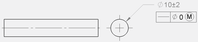

Hi All,
Based on the measured values of the following external cylindrical feature of size on a rigid part, what would be the bonus tolerance for straightness?
Measured LMC = ø 8.006
Measured MMC = ø 11.527
Measured Actual Mating Size = ø 11.979
Measured straightness = ø 2.724
My answer is this:
1) Finding the size: Actual Mating Size - Straithness = 11.979 - 2.724 = 9.255
2) Bonus = MMC - Size = 12 - 9.255 = 2.745
Thank you.

Evaluating the bonus tolerance for MMC straightness would require comparison of the actual local size vs MMC size at each cross section.
This would of course be for an axis/resolved geometry interpretation. The current Y14.5.1-20xx draft only includes a surface interpretation for MMC straightness, so its not really necessary (nor is there any guideline to how this should be evaluated besides the verbiage in Y14.5) to do this calculation.

The bonus tolerance idea -- and quantifying bonus in a table/chart -- is often useful to teach the general concept, since it's foreign to folks who only know the traditional style of ± tolerances. But as chez311 wrote, in the real world bonus on a form tolerance is usually difficult to quantify because the actual local size of the part is unlikely to be uniform/consistent.
You ask how one can verify it. The best way would be what's called a functional gage, and for the example you give the gage would be a sleeve (or simply a hole) with a diameter of 12.0 mm.
And I should also mention: If the drawing is using the ASME standard, and it's presumed to be a rigid part, then the straightness callout isn't needed because of what we call Rule #1 (automatic form control coming from the MMC of 12).

Just to add - the only requirement for conformance to the surface interpretation is that no point of the feature violates your virtual condition. Hence why it can be checked with a hard gauge of fixed size.

Why the "bonus" is not 12.000 - Measured Actual Mating Size = ø 11.979 = 0.021?
The FCF is nothing else than rule#1 explicit, isn't it?
If the FCF is removed (straightness Ø o at MMC) and the print is defined based on Y14.5, then I guess nothing change.
Am I correct?

Because use of the UAME to estimate size variation only works reasonably well if we assume there is very little form error ie: when we use it to calculate bonus tolerance/actual value for position. In the case of straightness, we are essentially trying to quantify form error - so wouldn't it be a bit backwards to make this assumption?*

*Edit: I should add as well that the text of Y14.5 explicitly states the actual local size in each cross section be used for this calculation:
Y14.5-2009 para 5.4.1.2 said:
As each actual local size departs from MMC, an increase in the local diameter of the tolerance zone that is equal to the amount of such departure is allowed. Each circular element of the surface (that is, actual local size) must be within the specified limits of size.

You won't hear any disagreement from me. I think Actual Local Size is one of the murkiest can of worms in the standard. You simply asked why bonus tolerance wouldn't utilize the UAME size - part of my answer was just based on general reasoning (form control should take into account form errors) and the other part simply the verbiage which we are dumped with on the standard.
As noted previously this can pretty much be ignored for straightness at MMC since we can utilize the surface interpretation and skip calculation of bonus tolerance altogether for a real feature. If you want simply to know the maximum bonus tolerance (or maximum straightness error) possible for a given feature controlled with MMC straightness then of course the calculation would be very simple being the difference between MMC and LMC size plus the tolerance value stated in the FCF.

Does your straitness tolerance do anything? Rule[ ]1 requires the part to be straight at MMC/MMB. Your questions and comments about bonus tolerance still are valid.

I only gave an example to start the discussion. If it helps, you can imagine the callout above as 0.1(M). My question would remain the same.
