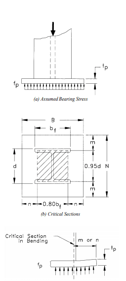

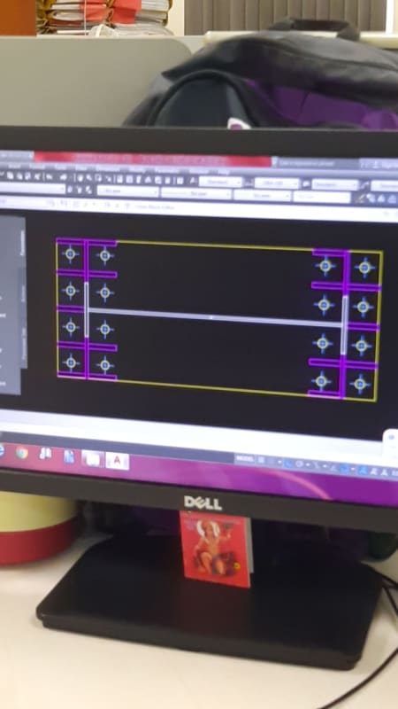

I am designing Base Plate as per AISC Design Guide 1 with large moment case.
In Bearing the the cantilever bending distance is m or n .What will be the effect if I use stiffners.

What does your compression block look like? I imagine it's centered under the flange so that all you have is the plate spanning in a three-sided manner between the stiffeners/flange. Pretty simple to analyze.
For the tension design, I would expect bolts such as these to sit up on chairs. This gives you better weld access, more length for the axial tension to be transmitted, and a length of bolt to pretension if the design demands it. The top plate can then simple span between stiffeners as a one-way element.
Having the outside bolts so far outside the beam section makes the flange work very hard in the cross direction. I'm not a fan of this arrangement.

As per AISC the m and n distance is measured from the center of flange to the edge of the Base Plate.Sinve I am using stiffners what will be the value of m and n ?
If I am ignoring the stiffners my Base Plate thickness comes around 50 mm which will result in more weight.For tension I know how to distribute the forces.I am just confused for bearing.
There is no "m" and "n" for this case.
On the tension side, you can use yield line theory to determine the required plate thickness. Maybe that thickness will be pretty high, considering this is a large moment case, and "ok by inspection" can be used on the compression side. For example, if the thickness is half the clear distance between stiffeners, then it's not really a bending problem.

Can you provide the proposed baseplate layout with column stiffeners shown? We are shooting in the dark, so far.

You can't use DG 1 without adjustments/modifications on equations and design parameters. Try this paper, see if it fits your need. Link
AISC DG 1 said:
Base Plates with Moments
Base plates with both axial loads and moments are not covered in the AISC Specification or the Manual of Steel
Construction. Engineers must refer to textbooks for design information, though not all texts cover this case.
Two general approaches exist for design, one based on the elastic behavior and one based on the ultimate
capacity. For each of these approaches, different assumptions are made.
You have to evaluate the stress distribution under the column within the area covered by the stiffeners. Other concept is similar to DG 1, as shown below, to get the plate thickness.
