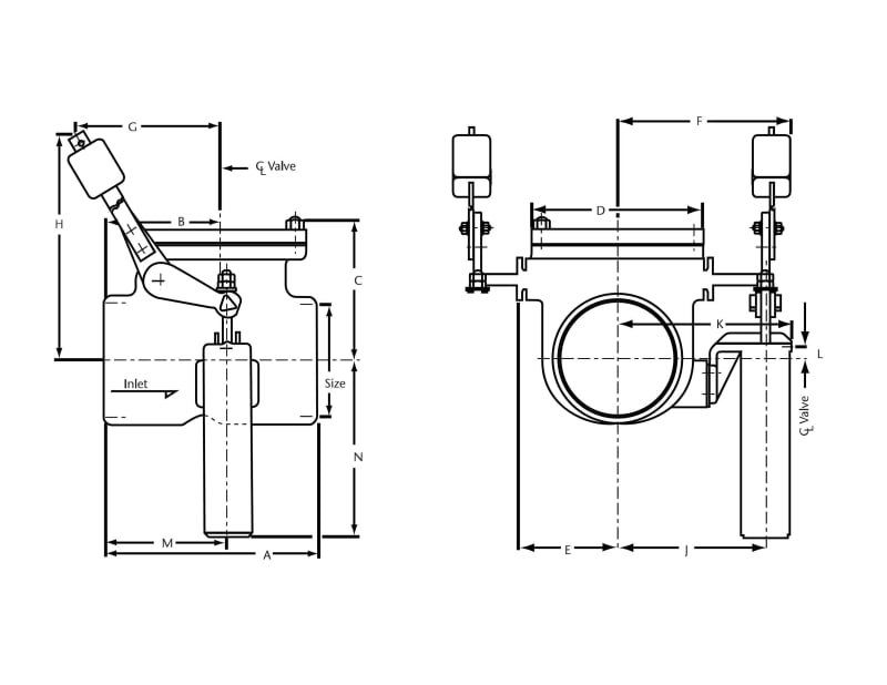

Cold reheat (CRH) check valves are required for large reheat turbines with an HP turbine bypass system. See the typical outline image file enclosed. The check valves prevent back flow into the HP turbine exhaust during start-up when CRH pressure is greater than HP turbine exhaust pressure. As the start-up continues, steam is admitted to the HP turbine, the HP turbine bypass valves are closed slowly and the HP turbine exhaust pressure begins to rise. I suspect that the chattering of the CRH check valves occurs when the differential pressure across the check valves is small.
Each check valve is equipped with an external arm with a counterweight. The counterweight is normally adjusted so the force of the check valve's disc (clapper) on its seat is balanced (zero force) or slightly positive. In addition, some check valves are also equipped with an air cylinder and spring. The spring provides a positive closing force on the disc. When air is admitted to the cylinder, the spring is compressed allowing the disc to move freely and open as pressure and flow from the HP turbine exhaust increase. A solenoid valve on the air cylinder exhausts the air in the cylinder to atmosphere when it is energized, allowing the spring to assist in closure of the check valve. Please note that the spring force is not sufficient to overcome forward flow through the check valve.
I suggest the you check the adjustment of the counterweight to provide a slight positive force of the disc on its seat. If the check valves are equipped with air cylinders and springs, I suggest that you check the settings and operation of springs and solenoid valves.
