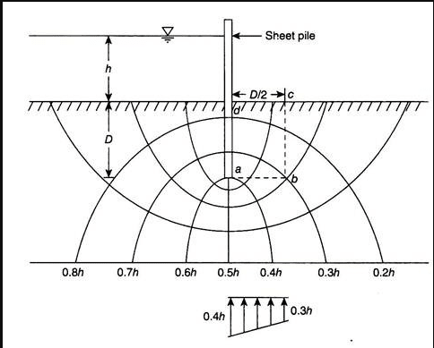

The heave piping can occur on the downstream side of a sheet pile, or seepage cutoff wall, when the built-up of upward hydraulic pressure at the toe exceeds the weight of submerged soil. As per Terzaghi, the critical heave distance is D/2 from the down stream face of the cutoff wall, of which D is the sheet pile/cutoff wall embedment length. In your case, where is the built-up of pressure differential required to cause heave? nk again.
In Fig., the equipotential line of 0.4h potential head passes through point a, and that of 0.3h potential passes through b. Hence, the average hydraulic pressure on the base ab of the prism abed is –
Upward seepage force per meter length of the wall is –
Downward force due to the submerged weight of the soil is –
Heave piping would occur when Fs > W. The factor of safety against heave piping can be obtained as –
where ϒ' is weight of the submerged soil, and hab is the average hydraulic head for a distance of D/2 from the downstream end of the sheet pile..
