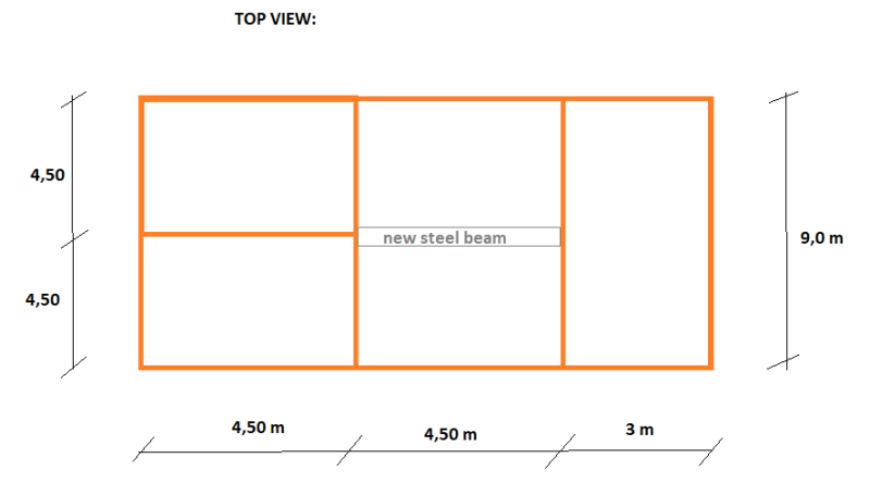

What's the other dimension? i.e. into the page.
I'm doing this because attic space wont be unused any longer plus screed on existing slabs,...
Therefore load on first existing RC slab will be increased and my calculations says that 140 mm thick slab is not sufficient.

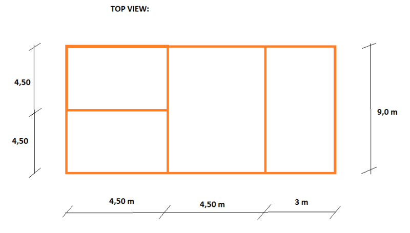

This is the plane view:
That plan suggests the slab is spanning the other way?
140 slab can’t span 9m
Besides others views, how that steel beam is going to be supported?
The whole structure is bearing wall system?
I think the connection design and the ability of the connected members to carry the load from steel beam also plays a role here..
You are right. The reinforcing and its direction and location needs to be known..
