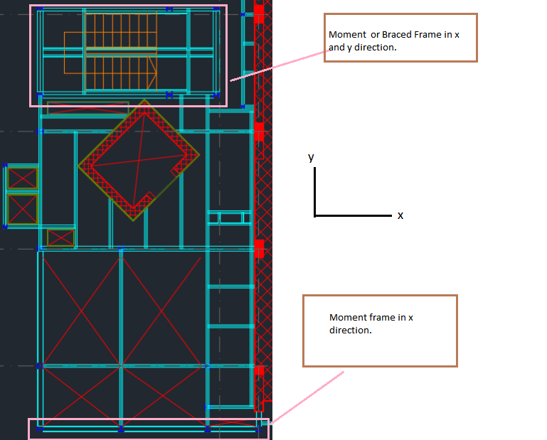

I have this steel structure plan view as the sketch shows. How do I handle with the lateral stability in this case?
As shown, in X direction most of the frames are supported by an existing concrete slab or shear wall. In Y direction some of members are supported by the shear wall.
Can I release the moment in all beams and consider this structure laterally stable without adding v.brace or making moment frames?
Or should I deal with each frame separately and change the beam to column connection to a moment connection where it is not supported on a rigid element?
Note: Base plates are pinned connected for all steel columns.

Here is the plan view again. I really would like to know your opinions.
Thanks alot,,

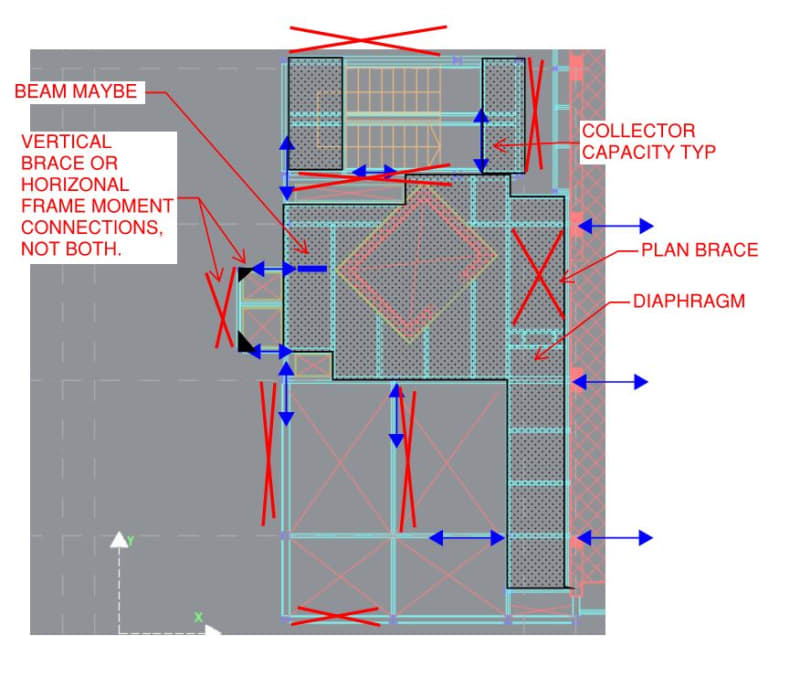

I've made a lot of assumptions here but this is how I might approach your situation. I sense that this is an industrial structure which often means:
1) You definitely want competent stability bracing and;
2) Diaphragms are often ineffective and/or non-continuous so some concessions to pragmatism must be made.
Obviously, adding in some more bracing is only going to improve stability and, perhaps, constructability. What I've show for bracing below is my practical minimum.

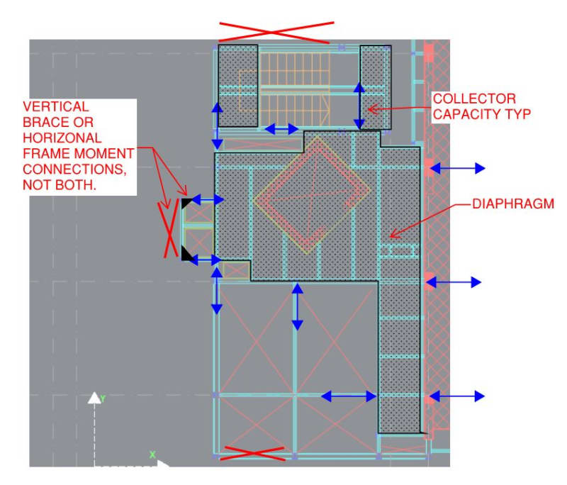

At the other end of the spectrum, you could spend a few extra bucks to do something like this and then be almost independent of diaphragm action, both during erection and in service.
