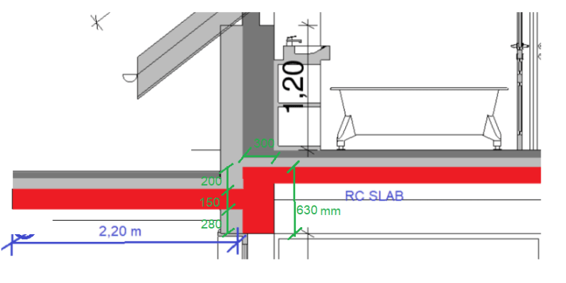

Residental building, the interior RC slab in not at the same level as the cantilever slab.
The cantilever part is non walking surface - only self and permanent load + snow load + wind load.
Can this be reinforced properly so it could work even tho slabs are not at the same level?
Dont ask why this cant be at the same level - it has to be like this acording to architect...
Thank you for help.
Assuming you have adequate space for the girder/slab turndown? (That part isn't dimensioned.) Most definitely. I've handled worse (although in industrial settings).

Sure, no problem. Its at a lower level for weathering. Normally you’d expect a 150mm step or so.

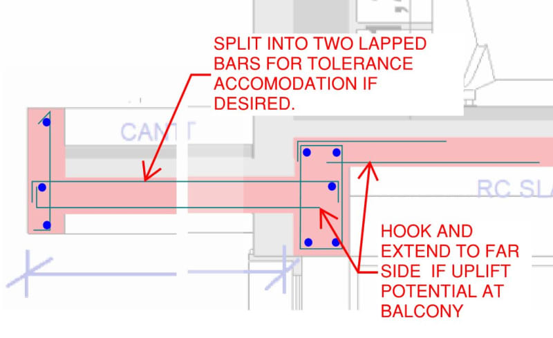

Yeah, it's a good detail for keeping water out of the interior of the building and, certainly, better than the reverse. Do mind your anchorages and development lengths of course.

But I also have problem with KootK's approach. I would want some continuation of the exterior soffit level into the interior. The top bars just hooking in the beam doesn't give me enough confidence.
I take exception to "just hooking". I specifically mentioned correct consideration of development and anchorage. Approached skillfully, the "anchorage" part will result in the requisite soffit extension, even if that extension exists within the beam width which is what I would recommend for formwork simplicity if that is feasible.

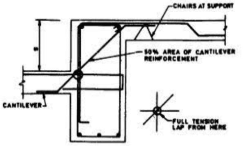

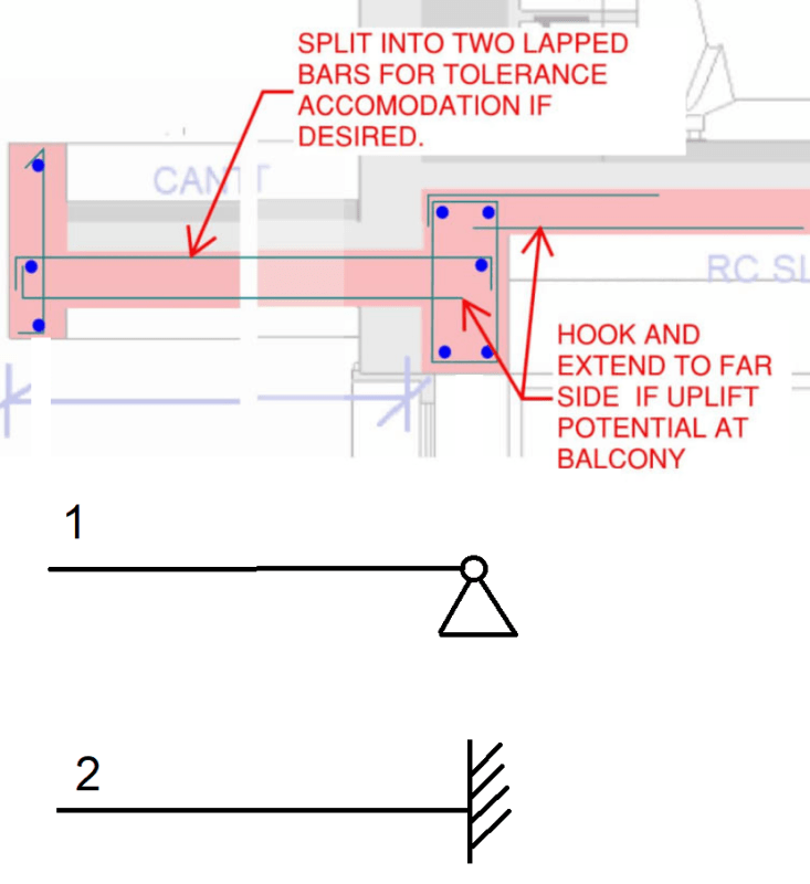

@Kootk - to me this detail is more like (1) which is a no go in this case than (2) which is what I had in mind.
Dimensions of the beam:
The detail KK has proposed is a fixed ended slab detail aka 2, the only part we are not agreeing on is the detail of the tension bar. Hoikie seems to think something like this would be better

No, as rowingengineer alluded, I was absolutely detailing to your [case 2], true cantilever behavior. In my experience, this setup is both common and free of reported problems. it's nothing more than a light duty slab fold in my opinion.
