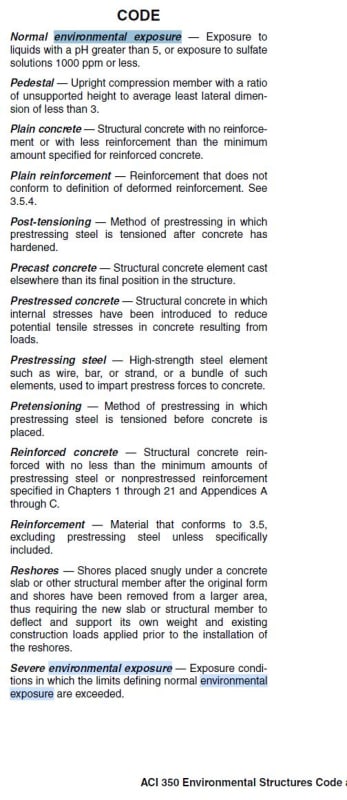

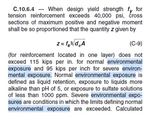

Here are some definitions that I have found in the ACI 360 code that mention Environmental Exposure:
Would rain water or possible flooding ever be considered as meeting the following:
[ul]
[li]a pH greater than 5, or exposure to sulfate solutions 1000 ppm or less[/li]
[/ul]

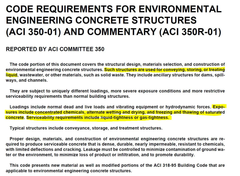

I just found this information contained ACI 350 (see image) which provides some clarity.
The mat foundation in question for this irrigation pump station has nothing to do with "conveying, storing, or treating liquid....". It is just supporting equipment and shelter. I believe this also goes in line with the comments you made about exterior equipment mat-slab foundations.
JoshPlumSE said:
True. But, what if the client has a requirement that the project be designed to ACI 350? I imagine that to be the case for just about anything designed at a waste or water treatment facility.
My original concern was that all concrete structures in a Water/Wastewater Treatment, Pump Station, and/or Lift station had to be designed to ACI 350 requirements (regardless if the concrete structure conveyed, stored, or treated liquid, wastewater, or other materials). This is the reason for the post.
My interpretation is that the preface of ACI 350 says otherwise (see image in my previous post), which lines up with ATSE's post.

I think you've answered your own question..that these don't need to be designed under ACI 350 based on the info you've given.
Unless these are intended to provide liquid containment to these filters in case of overflow/spillage. IE is there a perimeter containment wall with water stops at the mat slab foundation joint that would create a basin intended to contain spills? Does the client even want containment to be provided for these elements? I would think no, I've only really come across those containment provisions on industrial sites with nasty chemicals.
If not, sounds to me like these are just standard slab on grade equipment pads, and you don't need to meet any special requirements above ACI 318 requirements. The ACI 350 provisions are really intended to limit crack widths to prevent leakage of liquid containing structures. So if there is no need/desire to provide liquid containment, there isn't really a reason to follow them.
