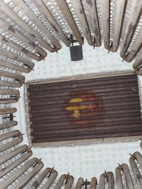

We have a 16 MW vertical API heater operated with 4 upwards firing Zeeco gas burners (natural draft). Our plant is in Indonesia near the seaside and we are facing corrosion problems due to the saline environment. The stack has a diameter of 1.7 m and rain water enters the stack in case the furnace is stopped. That caused already visible corrosion in the convection heater (Can be seen from inside the furnace as rusty round shade on the convection tubes).
I am planning to prevent rain water entering the stack by installing a chimney cap on top of the stack. The open side cross-sections of the cap will have the same area as the cross section of the stack so there should be no flow restriction for the flue gases.
Any objections or comments to install such rain cap on a natural draft heater?

Thanks Fred, plant is already in operation so modification of stack is not possible anymore. Our plant is near Singapore and we facing heavy monsoon rains. If the furnace is not in operation water enters the stack and causes corrosion in the convection heater. The plant is 100 m from the seaside so we have corrosive environment. The attached pic is from inside the furnace where you clearly see the water impact. It is basically the stack footprint. I need to study the plume height - never came across it so far.
Thanks for your input.

This water problem also occurs on barge mounted boilers, and probably lots of other places. The yellow stain hints at H2SO4, likely from sulfur in fuel oil. We can not burn that in the US anymore. If you are burning high sulfur fuel, you should not expect good service life in furnace exhaust from stainless steel.

Hi Fred, we just burning natural gas,basically without any sulphur. I havent been able to set up a scaffloding yet to have a closer look to the fin tubes. It is a 6" carbon steel fin tube. Thanks for your input
