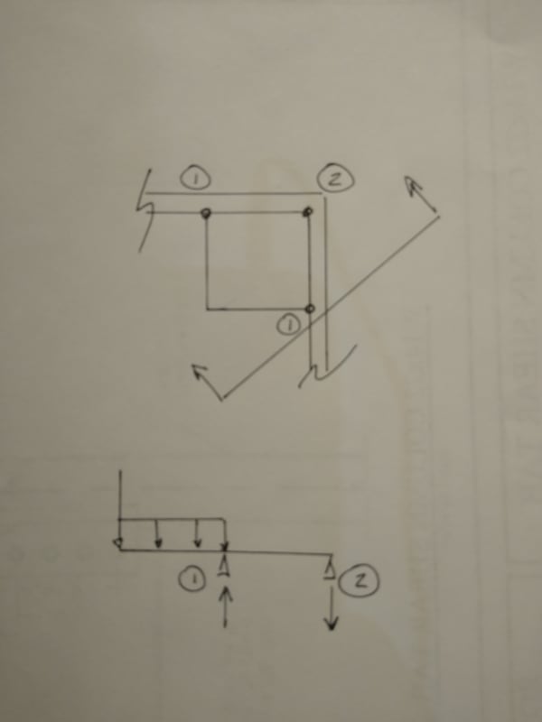

I don't think a proper moment connection is provided at the stringer / landing connection. (see pic below). it looks like a 2x4 is nailed as a diagonal support at the landing corner. KootK that representation is very helpful. Would a lateral reaction be required at the stud wall if the back of the landing is fully nailed to the ledger / stud wall. I would think that restrain would limit any spring action at the stud wall ?
That 2x4, as I indicated previously, was likely for erection. Koot's depiction of the restraint mechanism is what I was seeing in my head. That being said, that's a fairly long stringer for the upper stairs all sitting on this beam/stringer. Likely still ok, but something worth looking at nonetheless.

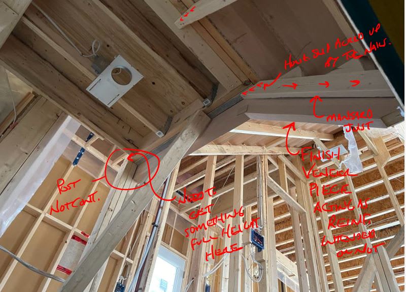

The mansard framing from KootK's sketch could work, but from the picture the landing edge beam interrupts the post in the wall. the deeper facing material I would guess was really just intended to be a finish veneer but is probably serving to reinforce the mansard condition.
Yes, it would be required in my opinion.
It's not a deal breaker for the stud wall connection to be a spring. Rather, it's just something to be aware of, and possibly account for, in your evaluation. The more springiness that you have in that connection, the more bounce you might get in the stair (phamENG's point). If there's a real world issue to be concerned about here, assuming full height studs, I suspect that it will be drywall separation around the bottom of the stringer knuckle when that joint tends to open up a bit as the wall studs flex laterally.

If you're using the full height studs as I proposed, and it's not been closed up yet, I'd take the opportunity to put a pair of studs on both sides of the stringer. KootK doth like symmetry.
Based on the picture from below the landing, that oak piece appears to be veneered. It might be engineered lumber or something else.
