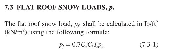

Glancing through ASCE 7, I'm wondering if you are dealing with a different set of equations, though...where'd the 0.7 come from?

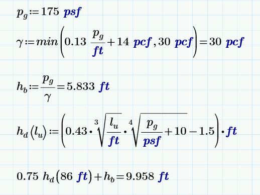

Throwing some numbers at it, it only takes about 90' of fetch to get maxed out to a 10' roof height.
Just this from ASCE7-10

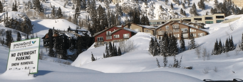

I took this pic late Feb of last year. Also at Alta, UT. Ground snow at Alta is 292psf!

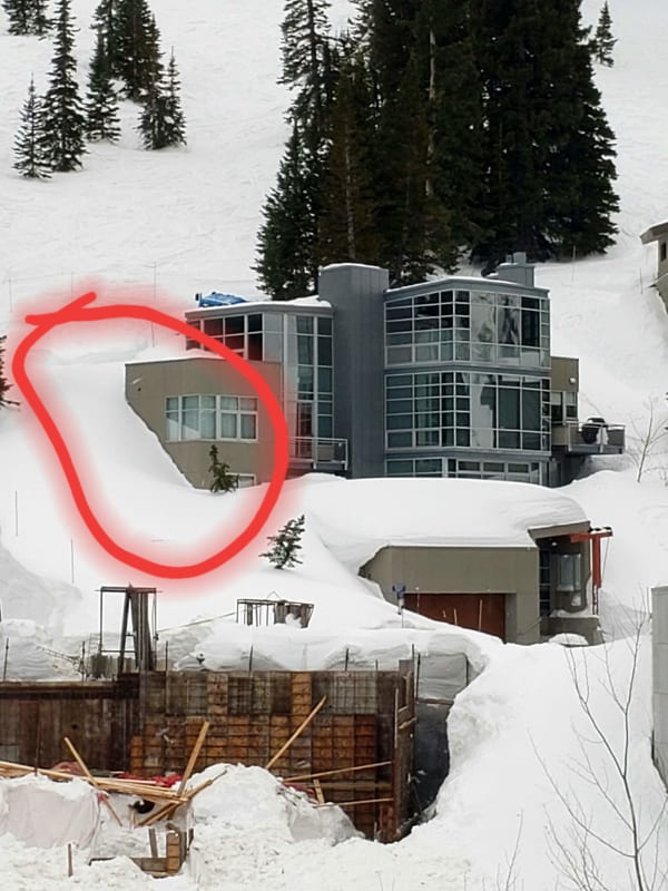

I took it because I saw the massive pile and thought "hmm, what sort of lateral pressure might a massive drift put on to a wall?" The entire ground level of the house is nearly buried. Granted, there is a bit of a slope but the pile must be at least 10ft tall.
Any thoughts on that one, re: lateral pressures? I suspect the load would be minimal, if any at all. Snow seems like it would be fairly stable once it starts to compact itself...?

Ah...that 0.7...of course. I usually ignore that equation because, again, snow load is so small here I can just apply ground snow load and still ignore it 95% of the time.
Taking a quick look at the commentary, it appears that the 0.7 is sort of a baseline exposure factor. So it sounds like you should drop the 0.7 for your deck if you're that low to the ground.
ASCE 7-10 C7.3.1 Exposure Factor said:
The normal, combined exposure reduction in this standard is 0.70 as compared with a normal value of 0.80 for the ground-to-roof conversion factor in the 1990 National Building Code of Canada. The decrease from 0.80 to 0.70 does not represent decreased safety, but arises due to increased choices of exposure and thermal classification of roofs.
dold - I can't point to a reference, but I looked into it once when I had a project with some snow drifts on the roof. I wanted to check the metal stud connections for lateral load. My research at the time suggested snow does not apply a lateral load. The lattice of ice crystals is stable enough - look at snow plows going through a large drift. You can get vertical faces of snow on each side several feet high. If you can cut away that material and have it not collapse, that suggests it's not applying a load laterally there.
phameENG: I'm not so sure about no lateral loads due to snow accumulation.

I've never had cause to consider the matter in any detail. But this cursory look does provide some indication that there might be something going on even if it is only P-delta within the pile that causes a slope failure leading to a block of snow gaining momentum and hitting the buildings or something.
Well then. I retract my previous statement.
Thank you for the correction.

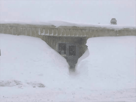

Blizzard in Gillam last year, drifts 10 or 11 feet high for unprotected buildings. I'll try and find some pictures of it. Ground snow up there isn't even as high as yours.
Since the full height drift scenario seems plausible, using that as your design case seems reasonable to me. I would set aside all the various C-factors and roof load equations and just calculate the snow density using the code equation: γ = 0.13pg + 14 ≤ 30 pcf
Then just multiply that density by the eave height and design to that load.
If the design ends up being impractical, maybe consult with the AHJ to see what their take is. They would probably have a good sense of what’s typically done in the area.
I agree with Bones. With the 175 psf load I'm guessing you aren't too far away from the eave anyway. With high snow loads like that it's crazy how deep drifts can get. I have pictures of Old Faithful visitor's center in Yellowstone that has snow piled up to the eaves.
I stand corrected, it was 2017.
This was the door to the arena. For what's it's worth, the design typical roof snow is 50 PSF up there.

That's right. Per the MathCAD that I posted earlier, the base ground snow get us 6' up a 10' wall to begin with.

My thought is that I may barf:
1) The glass thing and what my liability exposure is on that.
2) These custom homes are all glass and no shear wall. Barely there lateral. I'm almost starting to wonder if drift lateral pressures should be considered for the lateral design of the building globally. As phamENG pointed out at the beginning, most locations have a dominant wind direction. As such, an imbalance of drift seems altogether plausible.
