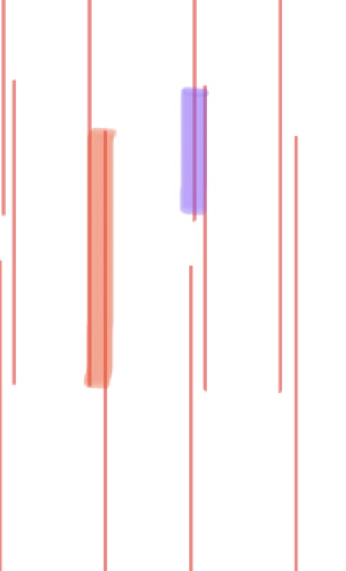

Hi Everyone,
Due to the existing conditions the reinforcement needs to be spliced as shown below. Is there any issue with the splices looking like this. I don't think so, since all the lap lengths are adequate for full development, but just wanted an outside opinion.

The blue splice is only half the length of the red (colour ref below). Which is correct..?
Staggering is good practice if possible but the OP said this is a restoration project. A lot of the times these splices occur at the repair boundary and there are no options (other than extending repair) to do so.
Correct, this is a restoration project so I am kind of stuck with the splices where they are.
As for the blue and red splices. Both are correct (blue length is the one required, red is just extra length). The red splice could be shortened to the blue splice length, but I want to eliminate having to unnecessarily cut bars in field.

Why are the double laps half the length of the single laps?
If all the laps are full development laps I wouldn’t have a concern.

The smaller lap length is the required length. The bigger one is just extra and is to avoid having to unnecessarily cut rebar to match the smaller length.

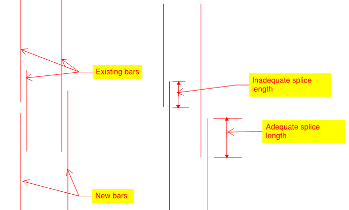

If that's the case, why not just splice the existing bars with the appropriate lap and eliminate the new, short splice bars. Even if this does not meet stagger splice recommendations, it should be at least as good as the proposal and it reduces congestion.

Essentially the existing splice location wasn't in the spot that was shown on the original drawings. So the new bars that have been fabricated and are being spliced onto them have a set length. So if the layout was to change like you have shown, the one lap would be too short. See below.
Ok, I'm assuming we don't have the full picture, but if the bars shown at the bottom are new bars, why can't they be longer so that they have an adequate lap? you have bars supplied that aren't long enough. If it was my project, I'd have them supply new bars of the correct length...or use the mechanical splices, but that's just me, I guess.
Where are they getting these short bars they're using to make up the lap? Do they have mill certs verifying the properties?
