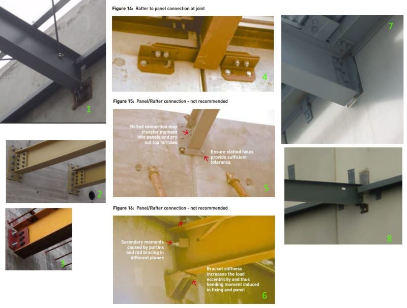

What is your preferred detail for pinning a steel rafter to a concrete panel?
Here are some details I grabbed from the web, to aid discussion.
Some considerations:
A. Cast in weld plates vs. anchors?
B. Flexibility requirements? How to assess the anchor tension?
C. Seat vs web support?
D. Detail at joints vs Detail clear of joints?
E. Consideration of rafter size on connection choice?
I like 1,6 and 7
A. I think both can work, however I do like to have at least 1 cast in plate per panel. I prefer expansion, casting or screw anchors with chemical coming last for rafter connection.
B. I find this depends on panel reo.
C. Either, they both have an eccentric load that needs to be accounted for.
D. Prefer clear of joints, edge distances seem to be increased with every new test of an anchor.
E.yes/load and also fixity requirements.
#7 Is the most common for us. #3 is a common repair detail if/when things are missed. I wish people would spec #4 since I dislike dealing with embed plates at joints very much, but it is exceedingly uncommon given the extra detailing/steel. From the erector standpoint I suspect many would like the Meadow Burke (Leviat) rapid lock connector, but it is not common in my neck of the world. Link Halfen and Piekko also have many shear connections that avoid welding as well, but some come from other countries and delivery is a problem.
#7 is my favorite overall.
#1 is my second favorite and, I imagine, probably does the best job of actually being a pin for the heavier connections. #8 looks even more "pinny" owing to the absence of the cleat stiffeners but probably only works for fairly light loads.
#2 looks to me to be a way to call the connection plate a flexural extension of the beam so that eccentricities can be ignored in a high demand connecting. It a clever approach to be used in hail Mary situations.

That type arrangement give good tolerances to assist erection, but if all those bolts are tightened, the connection can transfer moment to the panel, and it doesn't take much to initiate cracking. That's why a single horizontal line of bolts into the panel is preferable, similar to detail 4, but not necessarily at a joint. Joints are best avoided.

Images from their CAD file:
Piekko has a smart hidden connection for large precast beams. Here you can see grooves that allow vertical and lateral adjustment in the field.
That detail shows slotted holes on both legs on the connecting angle. So the only adjustment lacking appears to be in the vertical direction. I will be sure to report back on how my trial project goes.

Yes, all connections create prying forces, but with a single horizontal row, not much.
Brad805
"I bet they are relying upon the slots to relieve the bending forces"
Yes I would like to know whether the slots are there to relieve the bending on the panel.
If they are there for that reason and if bolts are only snug tight then there would be little moment transfer to the panel regardless of the number of bolts connecting the plate to the panel. The connection would be an improvement to 7 which is my preferred connection for tilt ups.
A lot of the places in Australia (eg Bunnings) seem to rely on this detail. I quite like it, but it's not one of our standard details. The single horizontal bolt line and torsional flexibility of the angles seems a good way to minimise unwanted prying. Are there downsides to this concept that you're aware of?

What are the issues with 3? Looks simple enough -just risk off hitting reo?
Is 7 site welded with ordinary paint repair?
1. I use the u-bar standard plate with extra N12 bars base on the testing from RJB
2. I model it in FEA, and check the ecc forces for all elements, and then do the same for the tilt panels.
3. The detail over the joint is a nice detail to reduce ecc, however I find on most of my projects it isn't possible to get panel joint and rafter alignments. In my modeling teh reduction in ecc force isn't as great as one would think.
