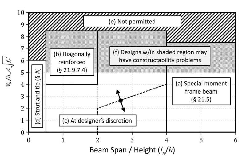

The following fig. explains the coupling beam design space. Excerpt from Seismic Design of Cast-in-Place
Concrete Special Structural Walls and Coupling Beams. (NEHRP Seismic Design Technical Brief No. 6)

I'm hoping to not call them coupling beams at all. Surely there must be some point at which a section of wall above an opening isn't considered a beam. Per the chart above, which I'm familiar with, I would need to do the strut and tie method for my 3'-4" wide, 53' tall "beam" above a man door. That's just not happening. This is more of a fundamental question than about specific detailing. That said, for those of you who have had 12 foot tall coupling beams, how did you provide hoop ties? It would seem you couldn't do that without having a lap splice in the hoops which I don't think is the intent.

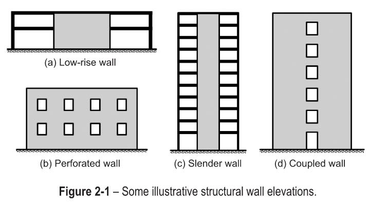

In this case, can be called perforated wall . You may perform analysis with a strength reduction depending on opening percentage. Or modelling with finite element always an option.

Thank you for that NIST report reference. It was interesting. I think calling this a perforated wall would be what I would want to do, but I didn't see any recommendations for perforated walls in that report. I don't think the word "perforated" shows up in the report at all. Appendix D of the report appears to indicate that shear failure of the piers between spandrels may be important. The report does address stacked openings quite a bit, but mostly concentrates on the wall region directly below stacked openings which is an interesting area of increased stress that ACI 318 doesn't appear to address.
Are there any references for the design of perforated concrete shear walls? NIST GCR 11-917-11 provides the below figure that appears to show a perforated wall is different than a coupled wall, but it doesn't provide any reason one wall would be considered perforated an another would be coupled. Are there any criteria for determining if a wall is perforated vs coupled?
Unfortunately I don't know of any geometric limits that define whether or not a beam should be treated as a coupling beam, but in your case I think it's more meaningful to approach this in terms of demand. With 600 ft of shear wall in one direction, I imagine that you don't require much ductility out of the walls. You might try some of the strategies below to assess whether special detailing is required.
• Model the coupling beams and impose the rotation seen at maximum drift (δ = C[sub]d[/sub] δ[sub]e[/sub], δ = R δ[sub]e[/sub], δ[sub]MCE[/sub] = 1.5 R δ[sub]e[/sub], etc.). You may find that the demand is low enough that the coupling beam behaves elastically.
• Assess the coupling beams according to ASCE 41 as conventional RC coupling beams with nonconforming transverse reinforcement.
• Design the coupling beams to remain elastic (V[sub]u[/sub] = Ω[sub]0[/sub] V[sub]e[/sub], V[sub]u[/sub] = R V[sub]e[/sub], etc.). See Paulay and Priestley Chapter 8 on buildings with restricted ductility.
• Design the coupling beams to remain elastic for the forces induced by a mechanism in the wall piers. Understand that this might promote a story mechanism during an earthquake. See Paulay and Priestley sections 5.2.3(b) and 7.2.1(b).
At a bare minimum I would provide u-bars at the head and sill to be lapped with the vertical wall reinforcement. As you alluded to, you may have to make your case to the AHJ if you decide to omit the detailing.
Some fun posts on eng tips related to this... unfortunately I've come to the conclusion that this in the abyss of "engineering judgement" whether to assume "fully coupled walls" vs "individual wall piers"
[URL unfurl="true"]https://www.eng-tips.com/viewthread.cfm?qid=479013[/url]
[URL unfurl="true"]https://www.eng-tips.com/viewthread.cfm?qid=478388[/url]
The first link posted shows how treating an example wall stack as "fully coupled" (not sure if that is the correct term) has about ~1.65 (0.8/0.52) more flexural capacity than treating the wall as individual wall piers.
To determine whether the walls are fully coupled though is really up to engineering judgement from the research I have seen.
