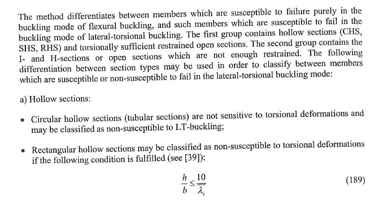

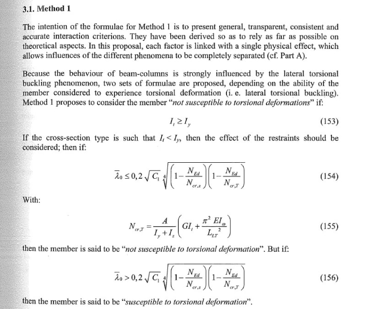

Interesting situation. Probably the most accurate method of assessing the capacity of your built up beam is to do some finite element analysis (either a linear buckling analysis to get the critical moment or a full nonlinear analysis in which the initial imperfection seeded in the beam geometry follows the shape of the critical buckling mode...this option of course includes the linear buckling analysis to get the mentioned shape).
just for information purposes, as it seems from the above that you are designing acc. to US codes, the snippets below are from a book called ECCS New Design Rules in EN 1993-1-1 for member stability. In showing the background to the establishment of LTB formulas for beam columns that are used in the Eurocode, some guidelines are given with respect to susceptibility to LTB. If you are wondering what the difference is between 'Method 1' and 'Method 2', the story is a long one, but the bottom line is that they both look at the same thing, and both are accepted in the European code.
